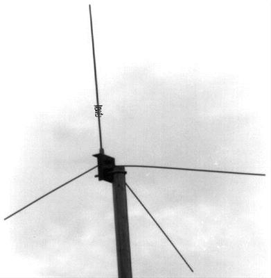

If you're going to use a mobile antenna, fab some ground radials to install at the base of the mount. They need to be 1/4 wave length. You can get by with 3 ground radials placed @ 120 degrees and bent downward about 45 degrees. Radials for 444.500 should be approx 6.6"
Here's a good calculator: Wavelength Calculator K7TJO
