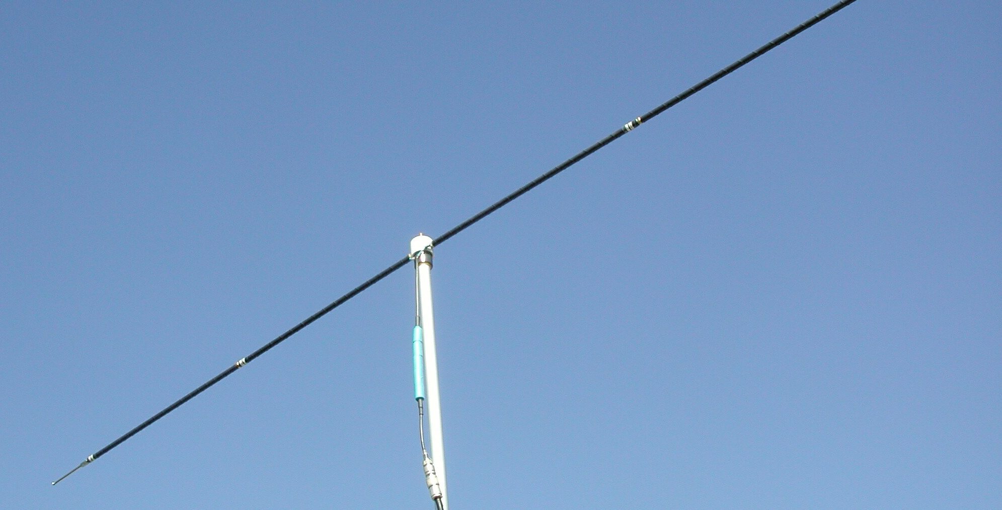

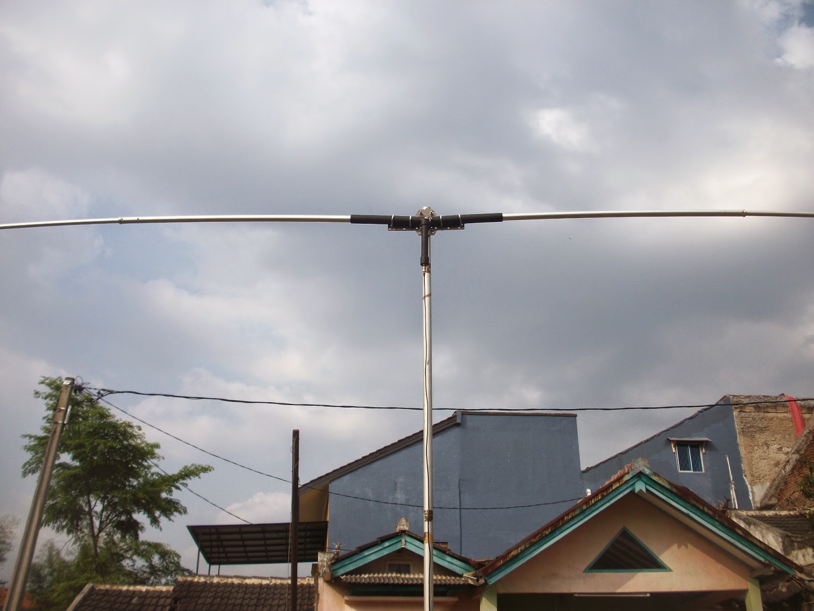

main-qimg-8ca86073afd13f65e7d1bba2152d76ef-c
Horizontal for DX/Long distance
Vertical for local chat.
One of each!!!!:cool::love:
