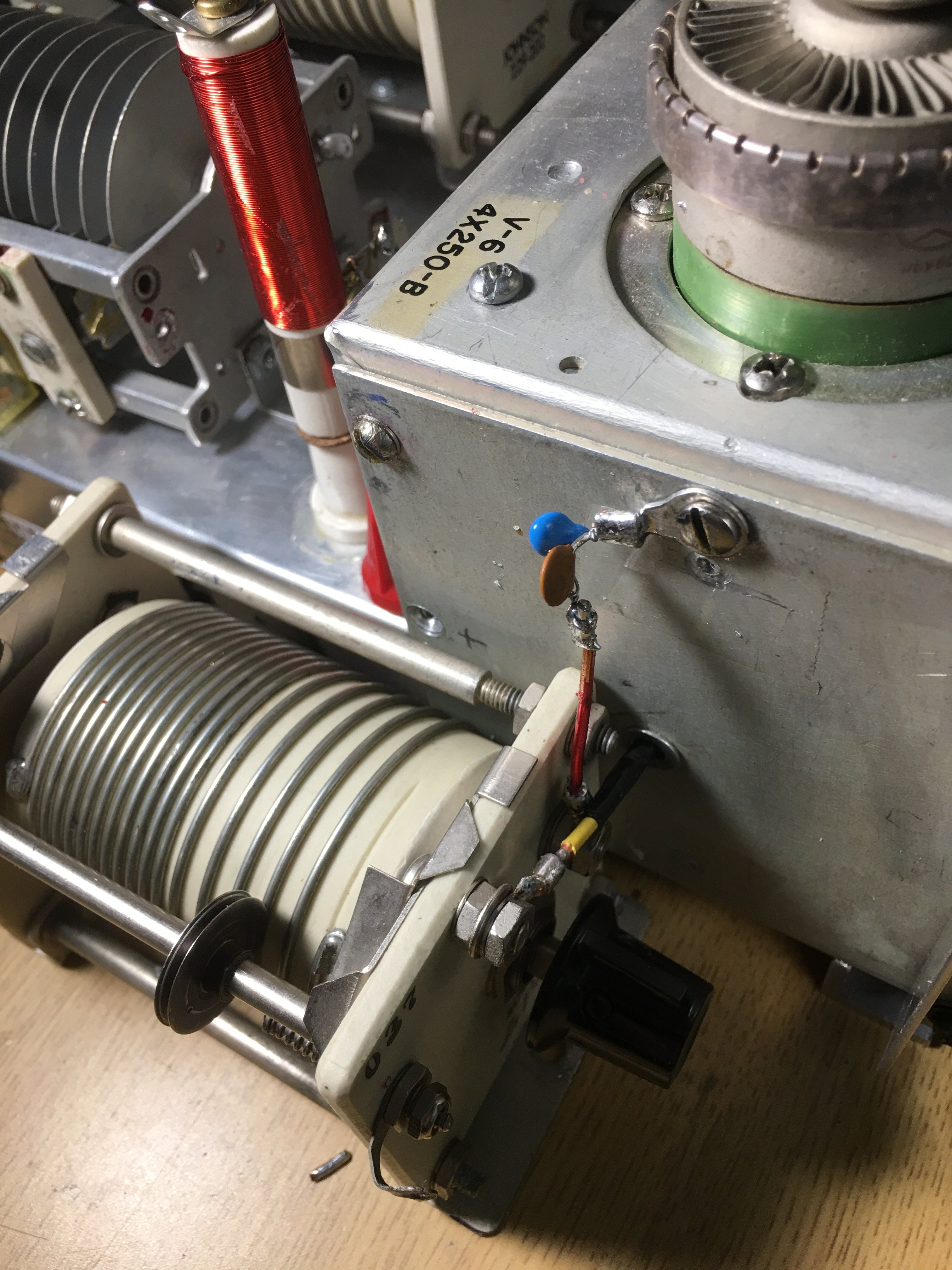

I was too fast to conclude total success. There was overall improvement but the same general pattern of too much C in pi network for 10-20 meters remains.
This picture is an abomination but I’m hoping to rule-out inductance as an impediment to 10-20 meters. The last round of testing showed highest PO on 10-15M without any Tune Cap connected. On 20M, it’s too close to call if min Tune C is helpful or not.
I will eventually ‘graduate’ to vacuum variable for the Tune C but product selection complicated by how to mount. I’ve never seen a vacuum variable IRL yet from what I see online, it’s the mounting system that’s difficult to acquire/fabricate. Not knowing how to mount makes it hard to commit to a Vacuum device. I’ve got lot’s of room but I find almost nothing on how to mount / associate matching clamps/brackets for a given product line. The little squat Comets for example: How do they mount? I see no mounting holes just a hockey-puck lookin’ device.
Anyway I’ve not yet tried the roller in the pic yet. I’ve got so much to write this time of year it takes away from doing anything . Maybe the picture is good for a New Year laugh.

The picture (above) of an external roller looks absurd and was a last resort. Fortunately, I don't need to pursue that route b/c the fixed inductors are working. It was the T-R relay compartment that precluded 10-20 meter operation (when reassembled). I did sample the input swr with the roller attached (as pictured) and it worked very well. The SWR dip was sharp/narrow when adjusting, not easy to find by Hunt & Peck.
The primary problem with low output on 10-20 meters was caused by the T-R relay compartment as those bands worked with the bottom cover removed. Over the past several months, I did repeated tear-downs to re-wind inductors, test input swr and reassemble. Each time I thought I had it licked after seeing large gains on bench while the bottom tin was removed. Premature claim of success b/c after I replaced the cover, Kaput! It took awhile for me to recognize it was the cover.
Chassis made from 3 aluminum boxes bolted together. The middle box contains Soft-Start and T-R relays (3 SPDT 12A relays glued together: 1 for Input, 2 for Output). It’s a narrow rectangular box 12" long 2.5" wide and 2" deep. Like a big capacitor.
I replaced the 8x cable w/ RG316 and reduced center core exposure; Wrapped copper sheet around Input relay (isolation?). Removed push-on Blade terminal connectors and soldered the RG316 directly to relay terminals. Also removed the COR keying board & wires (keying Buffer since repaired).
I’m waiting for a new set of machine screws & tap to re-thread the bottom cover fasteners. Soon I’ll test my better-targeted fix. Worst case, relocate/replace T-R relays. I can better target my efforts.
