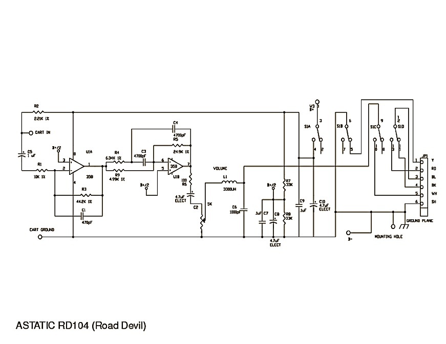

I also would like to see if I could dig up a schematic for the mic amplifier as well. It could be tailored in frequency response by changing some capacitors more than likely, or changing the electret element maybe to a better one (for only a couple dollars).

Road Devil Schematic
