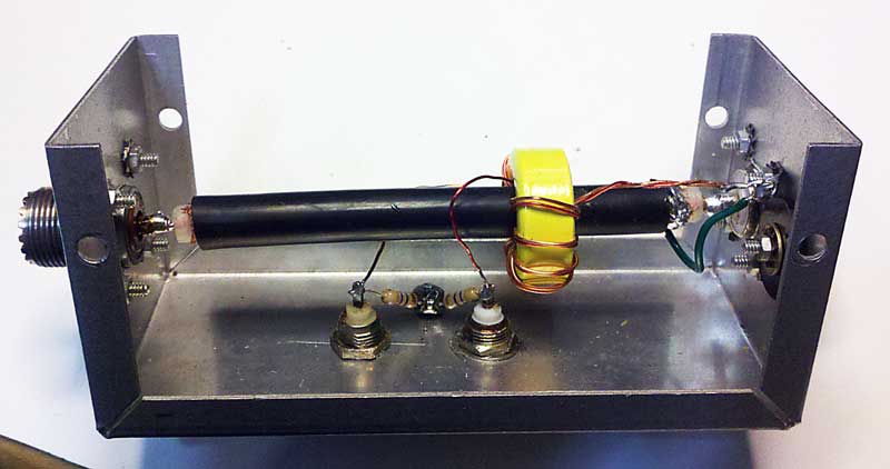

Well, this got out of hand quick. Truth be told the fact is I have only figured out a handful of things about this Scope. Im most concerned though with my Transmit and making sure it is leaving my radio in a good and clean fashion. Im still trying to find the correct settings to monitor that "wave form" and trying to figure out the best way to accomplish it.
Like I said above, un-calibrated is fine for looking at modulation waveforms and peaking circuits however for a true alignment calibrated is the way to go.
Like I posted earlier. you will need to make an RF sampler.
Radio output > RF Sampler > Dummy Load
Have a BNC connector out of the RF sampler into the scope. That is what I do, as I am sure others do it the same way. Search this forum for the RF sampler and build it your self. DO NOT buy one, as they are just too expensive and not necessary. They are REALLY easy to make. If you can't make one; then you shouldn't be working on radios. They are just that simple to make.
