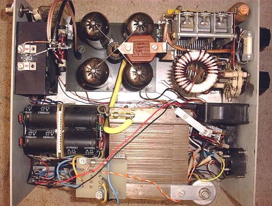

The hammies let the sweep tube amps die years ago. Them guys know what's going on. Why do the CB guys still insist on dealing with sweep tube garbage. Minimum tube these days is a 3-500. Step out of the 20th century and get into the 21st.
https://pa0fri.home.xs4all.nl/Lineairs/Frinear400/frinear400eng.htm
The fact remains they let the sweep tubes die in ham amps.
G,M* max power is 400W. The *519's make sense. Not as antiquated as you may think. The HVPS is also ingenious.
The 811* was always a transmitting tube with it's own set of limitations.
http://www.w8ji.com/811a_tube.htm
Metal (ceramic) tubes are not without their inherent complications. The 2500+ volt supply comes to mind followed closely by Russian tube availability and inconsistencies.
These days It's not a bad idea to secure a chunk of iron and purpose it for a tube(s) rather than the other way around. The choices expand with half, full wave, double, triple, quad, as well as choke or capacitive input. Designing the other way around will paint yourself into a corner or create a happy accident where a lump produces the correct voltage(s).
Adapt, improvise, transmit...
*UK "full" license power limit
