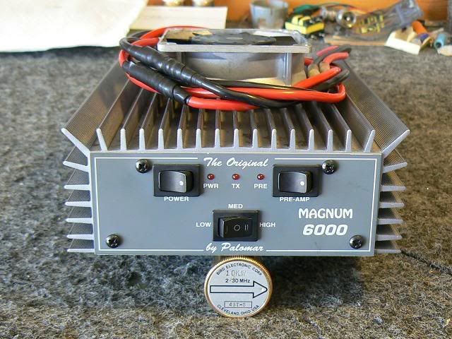

The Magnum series we used to get from Charlie had adjustable electronic voltage regulation, high and low drive settings and a all grey face with Hi Med Lo switch.

Didn't want to start another thread so I'll just try here .........Something is not kosher with the Pal 300 ..........it's certainly drawing amps ! the numbers on the bird around 250 rms, about 300 pep ..........the power wire and fuse in are getting hotter then hell ! ? it almost seems as if something is choking the amp ? it finally destroyed the 30 amp fuse that was inline .........I have seen 4 x 1446's really put out in other amps with small drives , not this one ! although they call it a 300 and it's at least doing that , but something really feels like the amp is being choked so to speak ........I'd say the power wire is at least 10 gage coming out of the amp but on fire hot ! Something just isn't kosher. Any thoughts would be appreciated. Switch
Switch, do you have a dummy load? How much drive, what is the swr, and what dead key?
I would not ask more than 80 dead key and go up with modulation on AM with 1446's.
They are only rated for about 80 watts each at 27 Mhz.
250 AVG is that swing on AM?
I have a 4 x 1446amp vertical transformer amp I am using in the pickup at the moment and I run a external 40 amp fuse at the battery. 1446's can draw as much as 12 amps if you hit them hard.
I don't drive this one hard at all. I run it at 250/300 watts SSB on a peak reading digital meter.
The power wires are upgraded to 8 gauge on the amp main board, and the power wires up to the front of the truck are big.
I added a fan because the heat sink is really too small but all if them are like that if you get long winded.
Jeff
Reactions: NZ8N and Switch Kit
Dummy load cantenna , 8 gage wire ,meter ,70 amp Astron ..........I knew something wasn't kosher when I was testing it , it went to a local who is pretty good with radios and amps , did the same thing to him and that's when he noticed the pos wire and fuse burning up hot and finally destroying the 30 amp glass fuse (we both basically got the same numbers AM/SSB ..........about 2 watts on AM 15 watts on SSB , just your basic old school 148GTL ........as far as those 1446s go , (what little I do know) 70 watts and can be rated higher on HF bands I believe , I have seen those do over 400 happy watts and run smoothly on low drives , those trannies have always seemed to like swinging for the stars .........I've ran the Motorola and Toshiba 80 x 4 over the years as well and never have seen what this amp is doing and acting like ........Oh it's sucking up the amps alright , no problem there it just seems like it's being choked for some reason ..........I mean finally blew that 30 amp glass fuse and just wanted to melt the power wire from the inside out ?
