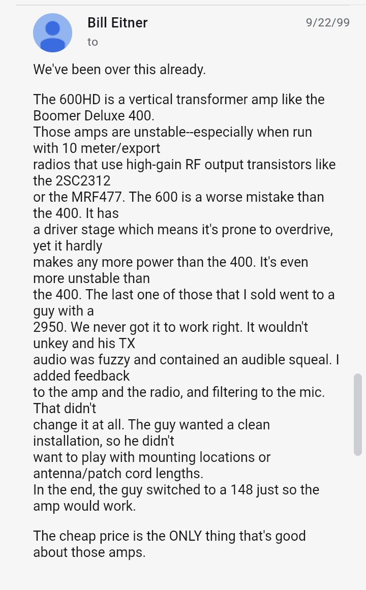

I ran across this from Bill years ago about the 600.
Jeff
