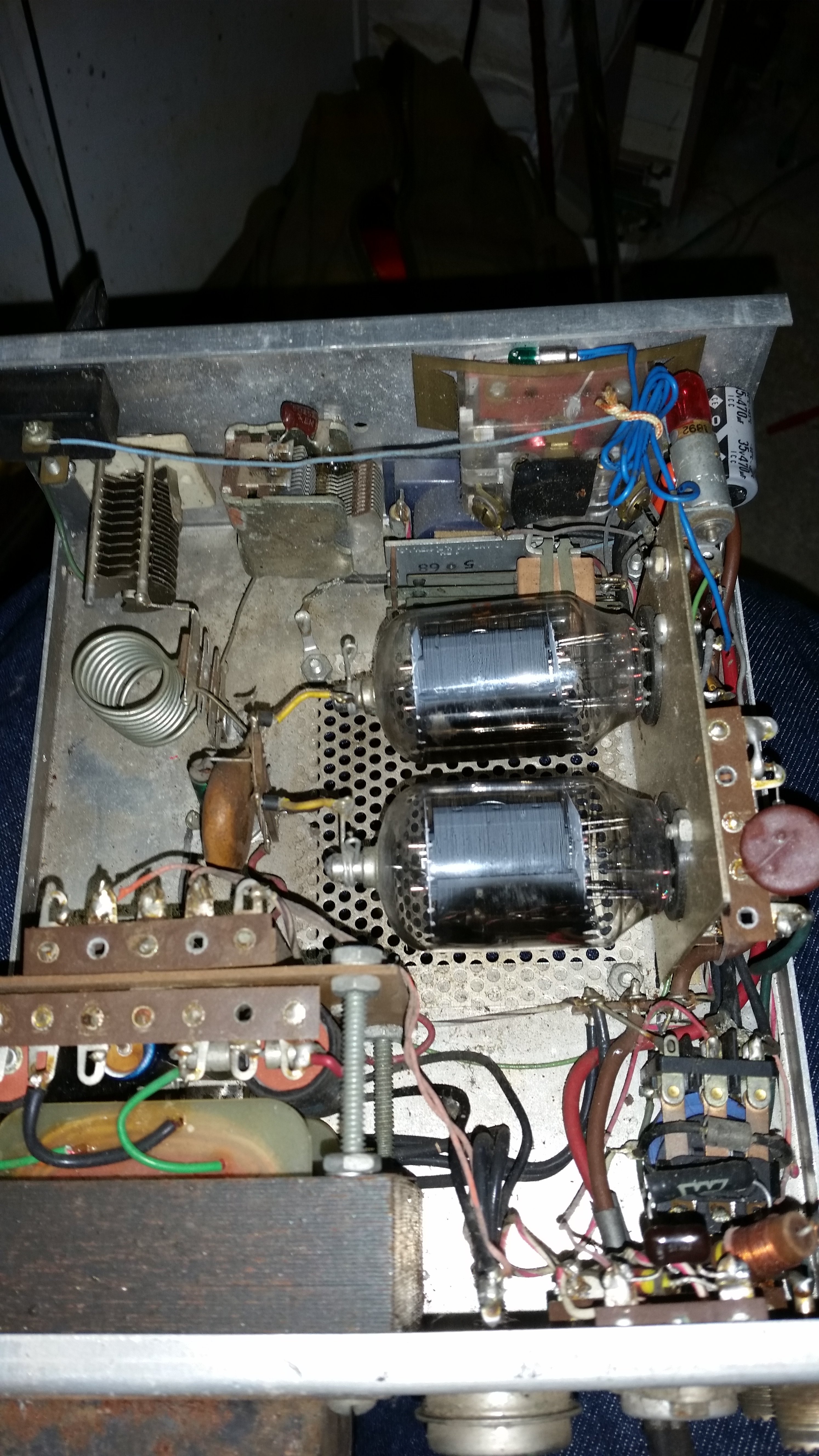

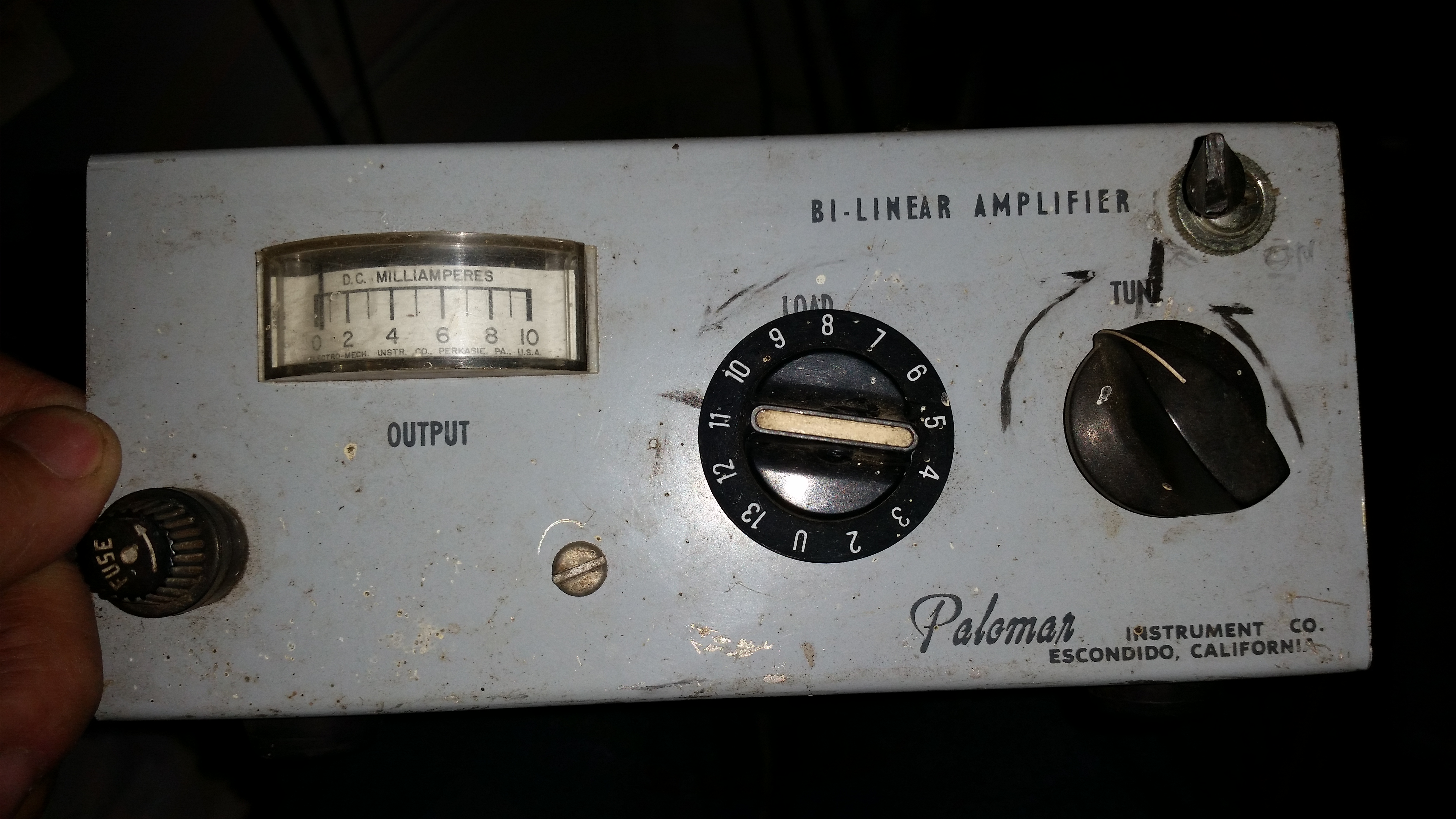

I HAVE A OLD PALOMAR TUBE LINEAR, LOOKS LIKE 310 MODEL WITHOUT TOGGEL SWITCHES ON FRONT, OLDER MODEL, JUST PLATE AND LOAD, AND METER. I DONT KNOW THE MODEL NUMBER OR THE 2 TUBES INSIDE MODEL NUMBERS ARE, WOULD LIKE TO BUY NEW TUBES BUT RUBBED OFF OLD TUBES INSIDE. I CAN EMAIL PIC'S OF LINEAR FRONT AND BACK AND INSIDE. NO MARKINGS ON LINEAR FOR MODEL NUMBER AT ALL, PLZ HELP.
WHAT IS THE MODEL NUMBER OF THIS PALOMAR AMP? WHAT ARE THE MODEL NUMBER OF THE 2 TUBES INSIDE? PLZ HELP ME FIND OUT THE MODEL NUMBER AND TUBES THAT ARE BEING USED? THX AND 73'S

the load knob is not original,... looks to be off a TV set.
if memory serves me correctly, the 310 was a 4 tube mobile amp.
this looks a lot like a model 50............ 2 6JU6 tubes
Reactions: Sonar
yes you are correct, my amp is the palomar 50 with the 2 6ju6 tubes, thank you so much, my amp had no markings on it and the numbers on tubes were wore off. so I had no idea what amp and tubes were. thanks again. 73's
