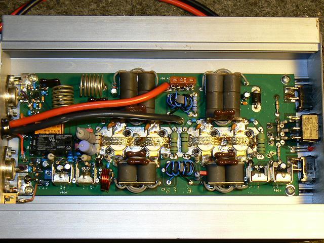

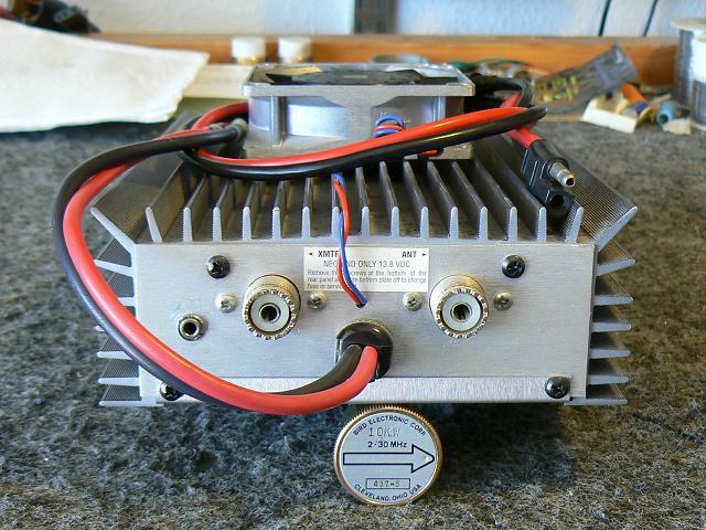

Some pics. The RF sensing circuit is in the bottom left hand corner. I installed a keying line by simply running a wire from the emitter of the keying transistor to an external 3.5mm jack ( you can see it on the back of the amp). When grounded (common ground) , it will key the amp. I prefer this over using the RF sniffer so no relay chatter on SSB and no RX delay after unkeying. Also added a fan.
