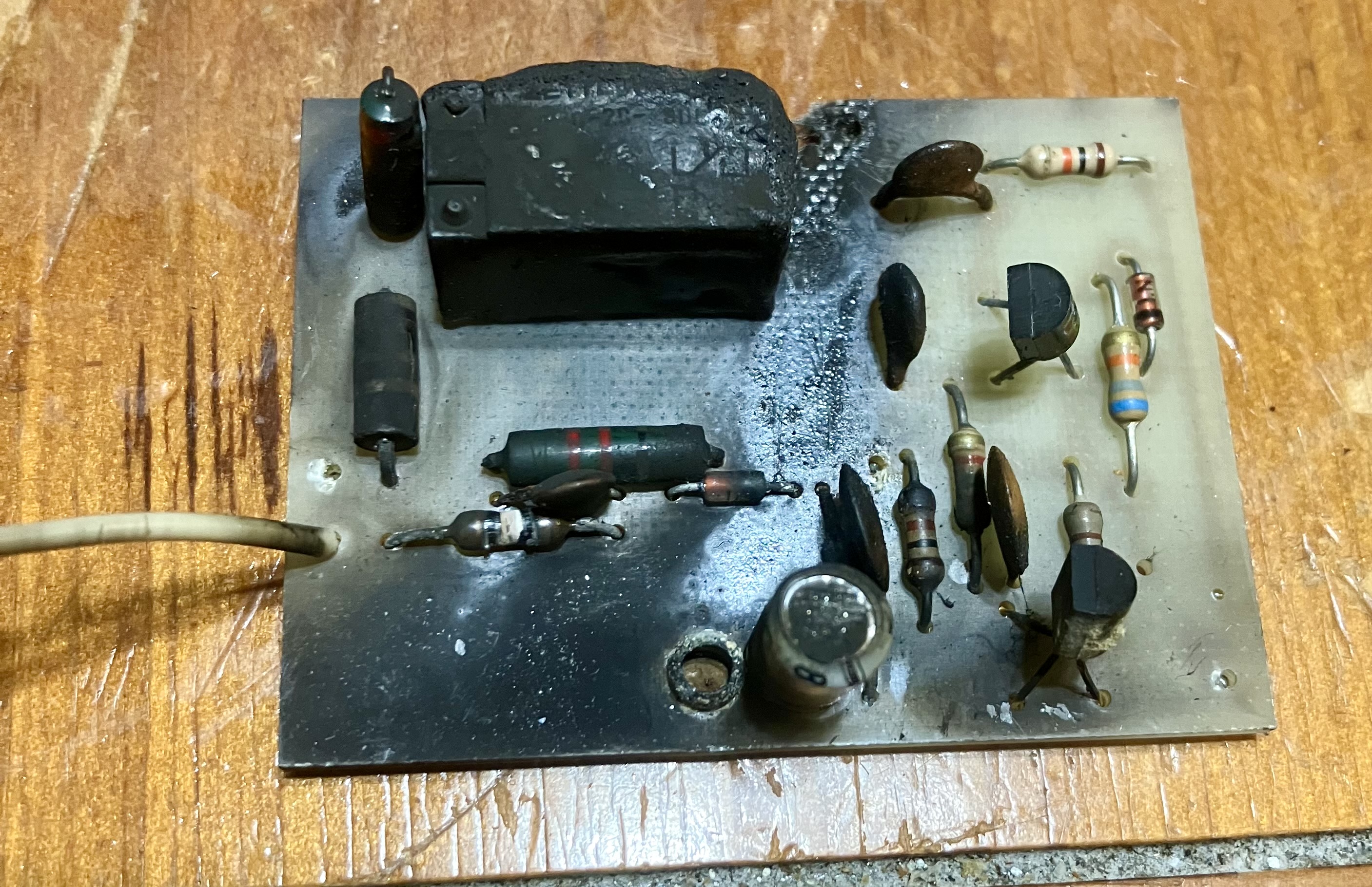

If you can only find AC in this amplifier, you've found the problem with the original keying circuit. The amplifier must have DC to run its keying circuit.
As I took a moment to look at your picture, I can confirm the reason why you have lost dc. Look at the small gray electrolytic capacitor mounted to the terminal strip Behind The Rocker switches. It's positive terminal is snapped off of the anode side of the diode. Leaving Raw DC that will not operate any of the relays properly. Check that capacitor see if you can solder it back or if it needs to be replaced.

The 'sensor' is the antenna relay. It passes the connection between radio and antenna straight through while receiving. The small circuit board to its left in the pic has a small blue lump on it. The lump is a smaller relay that enables or bypasses a receiver preamplifier circuit that's alongside it. One of the front-panel switches turns this feature on or off. If it were a Maco, this would be one position of a three-position standby switch. That small circuit board also contains a sensing circuit. When you key the mike on the radio, it "borrows" a tiny sample of the radio's output power and rectifies it to DC. That tiny DC current activates a transistor that energizes the coil in the big black antenna relay. That relay has three circuits, one for the radio coax socket, one for the antenna coax socket and the one in the center is used to shut down the tubes while receiving, and power them up when the relay closes.
And that's what causes me to suspect a failed tube causing an overload. Can't overload anything until you apply high voltage to it. And that's what that center circuit of the relay does when it goes "click" or gets bumped causing that circuit to close.
Over the years now and again an employee would be testing the tubes from a customer's radio or amplifier and find one with a dark filament that just would not light up. I would suggest making a mark on the wall with today's date, since this is such a rare occurrence. That glowing filament is the most-reliable part of the tube. What cause them to fail will be other parts if the structure inside.
One way to see if I'm right is to unclip the spring clip from the cap on top of all the tubes. This will unhook them all from the high-voltage power. Now turn on the power, warm it up and then press the relay's armature down with an insulated screwdriver handle or some other insulator. If it was a tube that made the fuse trip, the power will stay on. This will tell you that it's time to find a tube tester and identify how many of them look perfect, but have a hidden electrical failure inside. My prediction would be more than just one.
The keying circuit, the RF-sensing feature that keys the amplifier when the radio's mike is keyed is famous for going out in that circuit board. It's either a board they bought from Maco, or copied. We learned the hard way to remove it and use a more-reliable keying circuit in its place. The receiver preamp is a bad idea to begin with.
