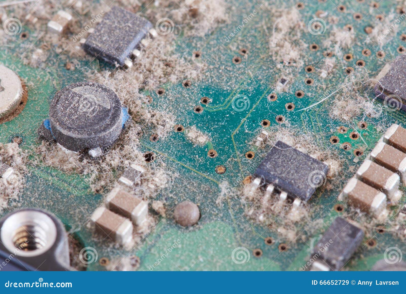

What is the least invasive way to clean this board? I would think air..
Q-tips? Back when I blew out the TV the Canned Air was not on the market yet.
Completely understandable, and that raises a good point!
I used my air compressor the other day to clean my P.C. w/ low PSI (I hadn't drained the tank, no line filter) and I noticed some water was coming out, not good! Use a line filter to trap moisture if you decide you have to use your air compressor in this manner (not recommended), canned air would be more ideal, and the pressure won't be excessive.
If you use compressed air regulate it to about 20 psi. That's what we used in the service and in most electronic shops I worked in or use the can type. To clean boards there are cleaners in spray cans such as MG Chemicals Super Wash. You can also clean them with alcohol or even wash them in a sink. We used to clean a lot of dirty boards in a sink with a little detergent and a small brush. Blow them off with some air and let them dry. Doesn't hurt a thing. Electronic parts are all sealed. Tuning cans will dry right out. Of course with a radio you need to keep the liquid off the speaker and out of the meters. Covers can be washed in the sink with water and detergent. Auto polishes and waxes shine covers and front panels up nicely.
