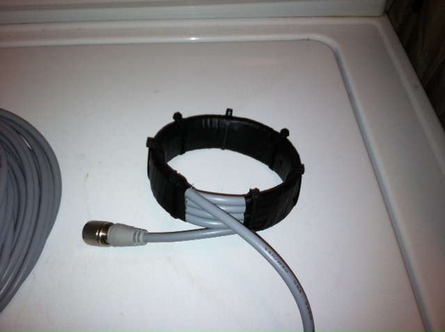

I can't speak for LMR400, as I run RG8X (which is far more flexible). What I can tell you is that I'm not splattering on either myself or my neighbors (believe me, I've tried, and I've asked). I have an RF Choke directly below my feed-line (5 turns @ 4 1/4 inches diameter) and I've been doing just fine for years on 11 meters.
Here's a picture of my RF Choke. I actually wrapped it around my washing machine's agitator (which just happens to be 4 1/4 inches in diameter, lol -- no, I'm serious).
Reactions: 2 people
