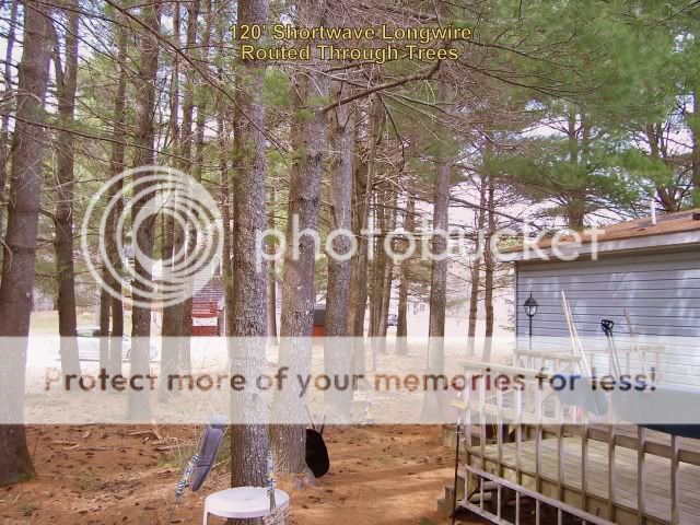

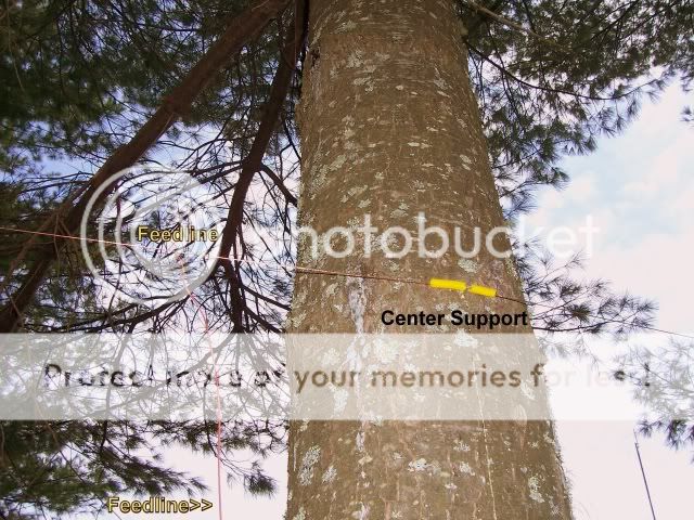

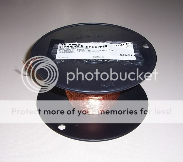

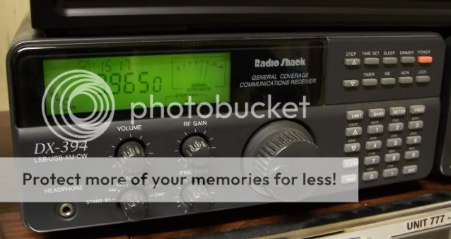

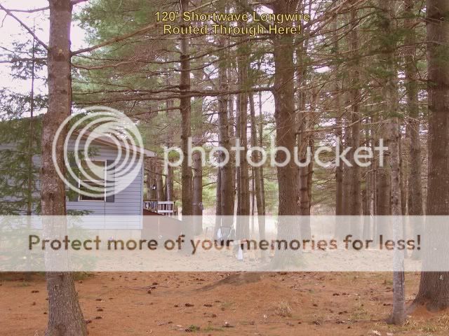

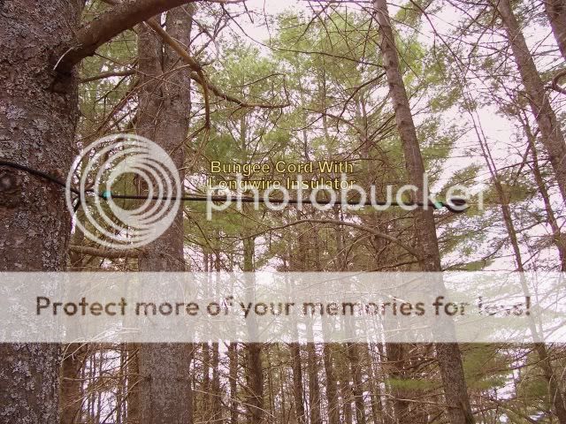

Besides CB radios I also enjoy listening to the shortwave radio. Had a longwire antenna from Radio Shack which was about 70' but it got damaged. The insulators and other hardware all in great condition. Went to Home Depot and bought a spool of 500' stranded bare wire 18 gauge. Well this time I wanted to build a longer antenna and chose a different direction. This 120' longwire is doing its thing. Pulling in stations left from right in the evening. I enjoy listening AM broadcast stations on the KHz spectrum also. The Radio Shack DX-394 General Coverage Communications Receiver has been in my ownership since 1996. It does a good job but as my needs grow I may upgrade to a brand/model more full featured. Below are some pictures of my area. Lots of trees here so I really had to think things out for position, take care...Bulldog
