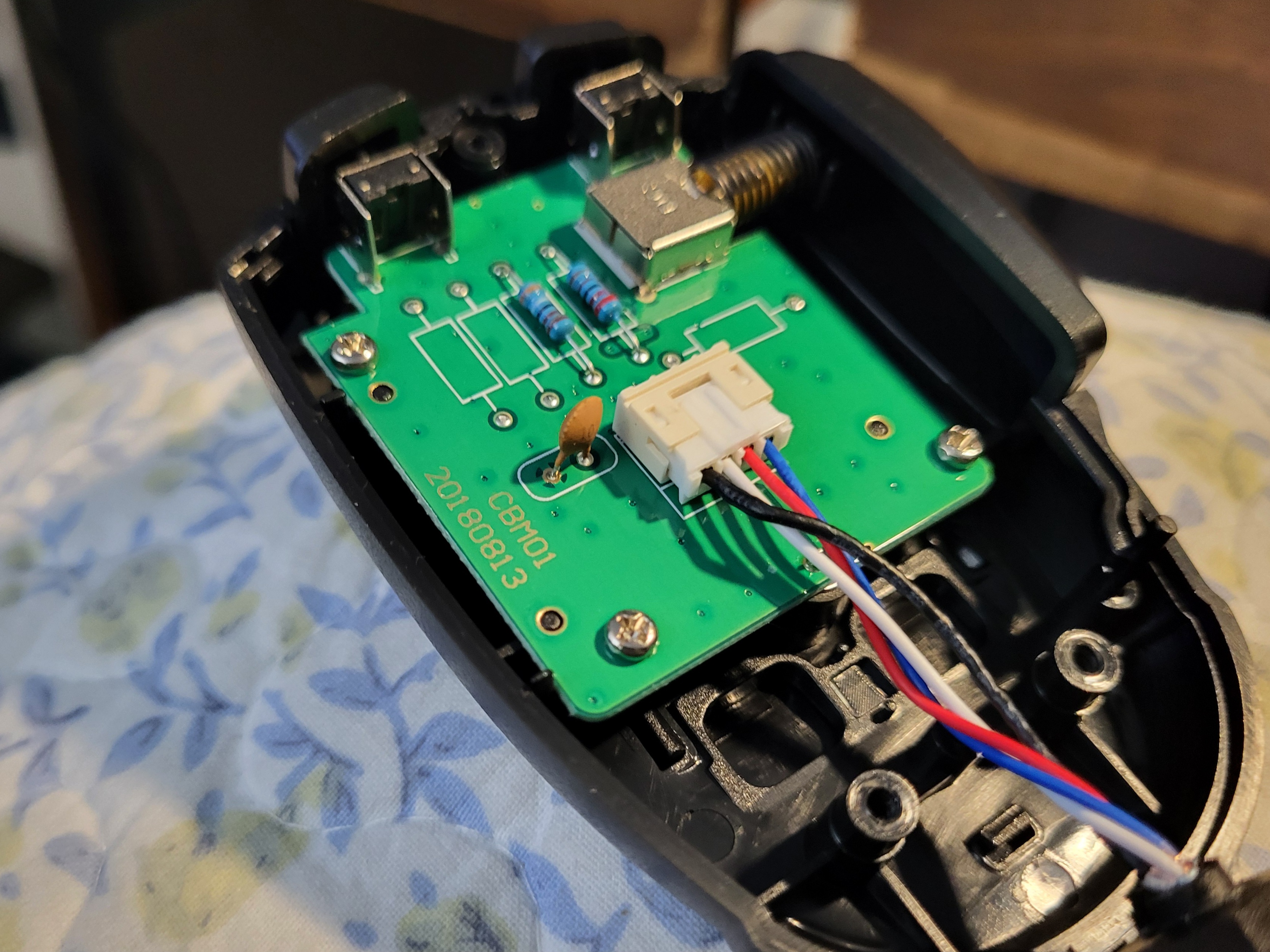

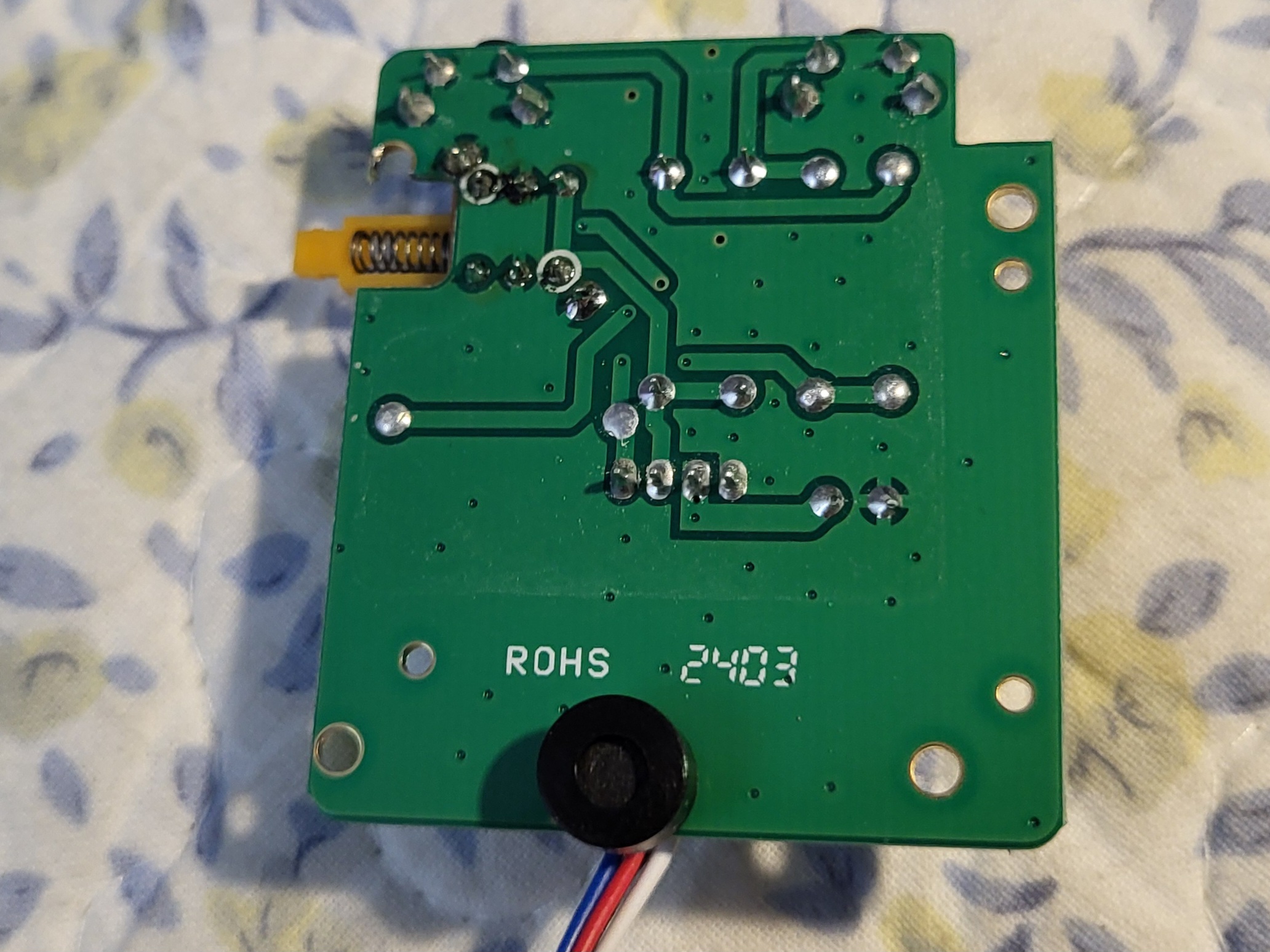

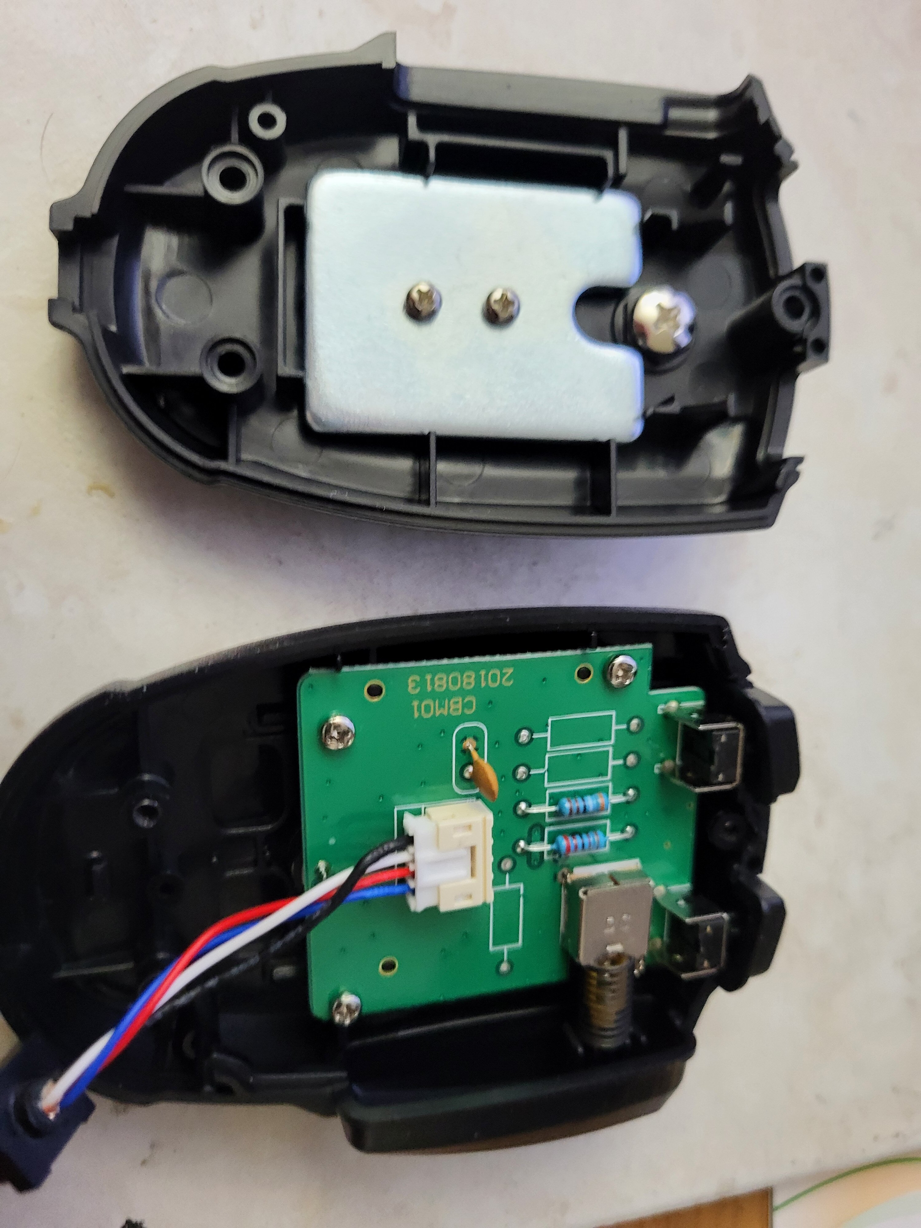

The microphone feels light in the hand, as most modern hand mics when compared to say, the RCI-2950's mic. I've read other reviews who also mention this, too, so I decided to open it up to have a look at what's inside. This revealed why.. It's mainly due to the element itself, which is a tiny "electret" (meaning it requires 'phantom-power' from the radio, but is amplified. the mic actually has a metal WEIGHT mounted inside the back half of the case. It does an exceptional job with the human voice. But this rig is also capable of running a DYNAMIC microphone, switchable in the menu! Very cool! But IMHO, "if it ain't broken, don't fix it"!
PIC OF MIC OPENED-UP;

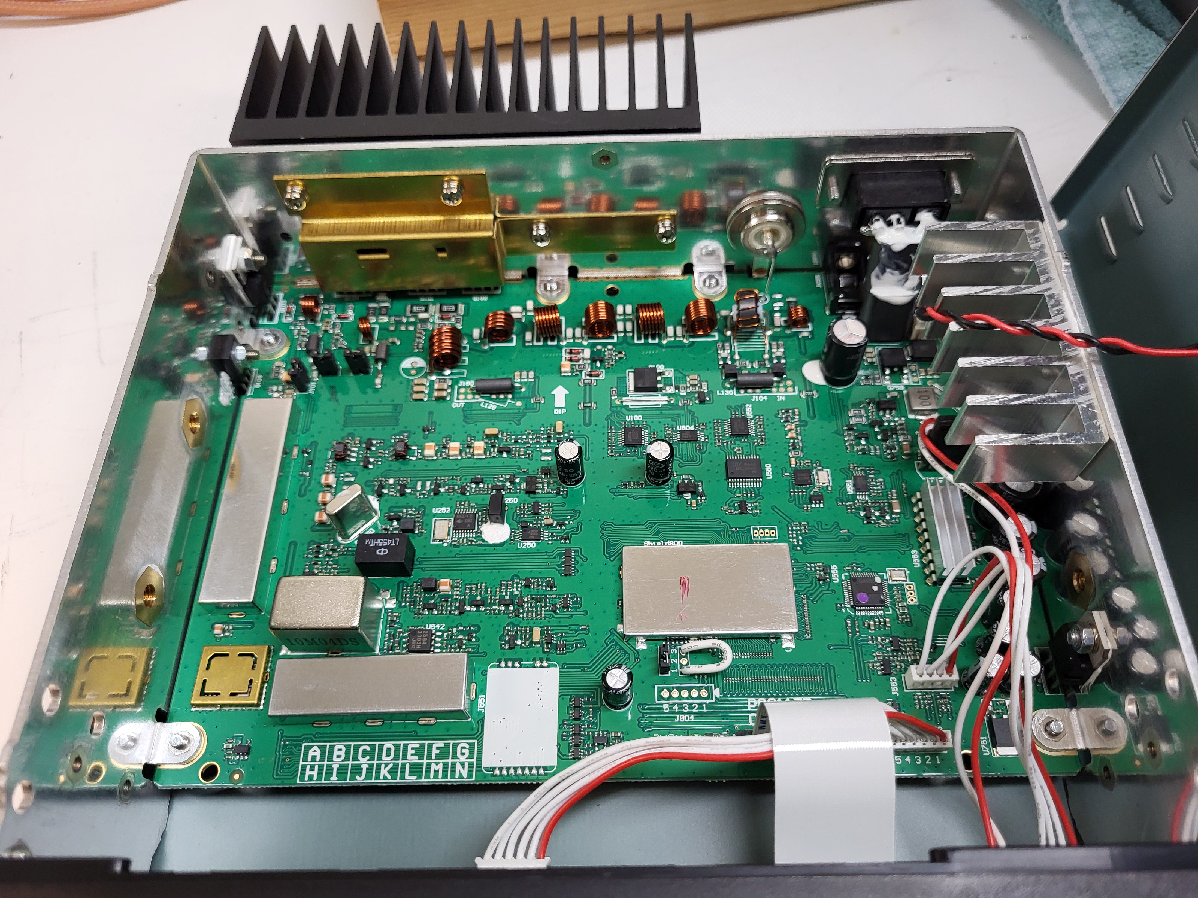

TOP-DOWN VIEW;
BOTTOM-OF THE RADIO (Speaker side) VIEW;
Assembly quality is visually-apparent, as shown above. I didn't see one cold solder joint! And I looked with a loop for one. From what I'm seeing in front of me, it's exceptional "bang-for-buck! It would be interesting to see the Qixiang (pronounced, 'Shee-Shung') assembly line.
