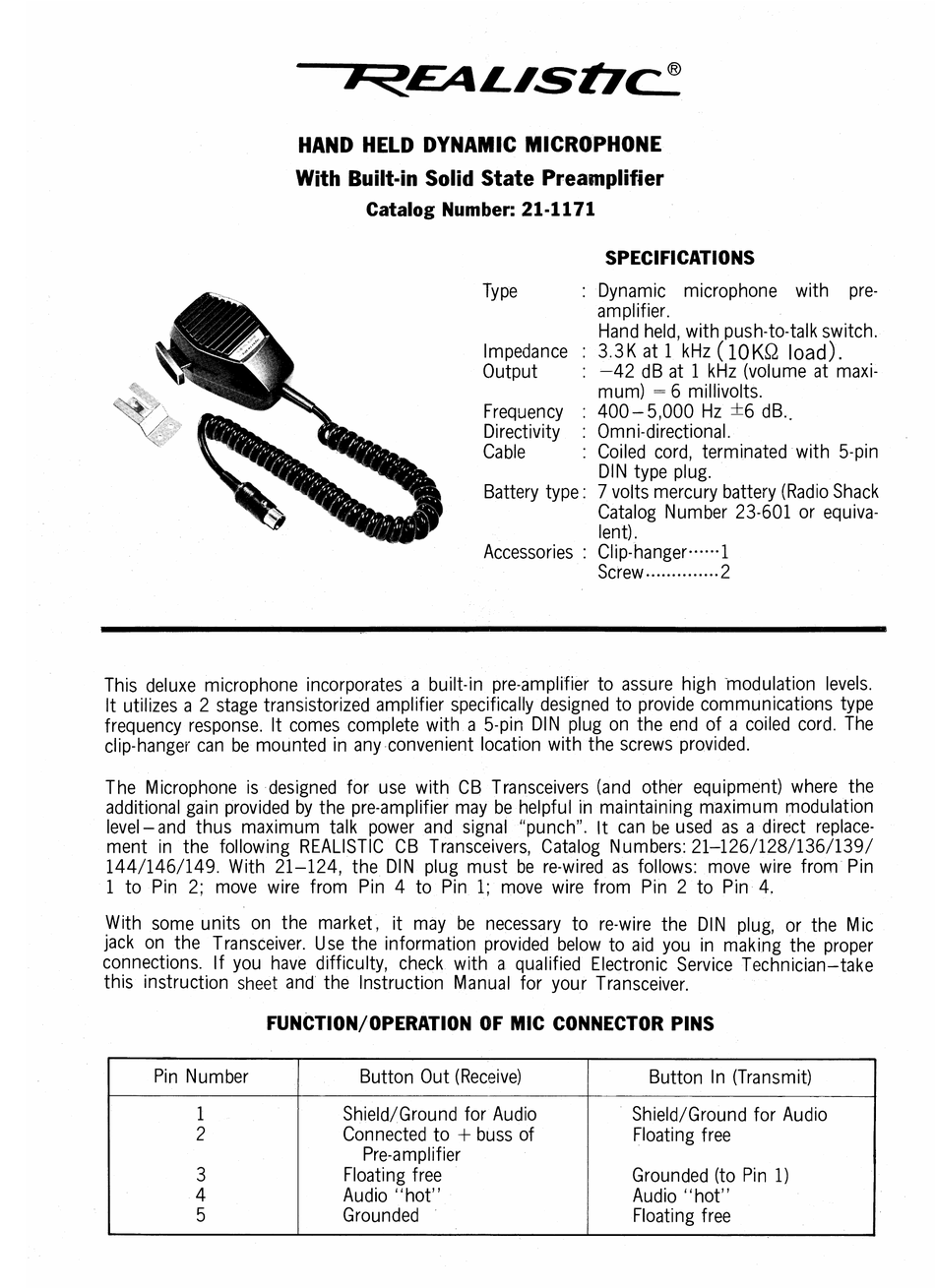

Just did what the OP did, went back and looked at old RS catalogs. There was a mobile mic with a two transistor amplifier, the catalog number was 21-1171. Might not be the same board as the 21-1170, but it's no worse than what you have now:
The switch on the bottom may be to switch between electronic and relay keying. The mic is about the right age for that to have been a thing. Of course, I've never seen on in the real world, so I could be wrong. Probably am.
