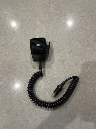

The mic I am using is this more modern RadioShack 5 pin din and not the original mic that would have been supplied.

That condenser stock mic will only work on a radio that has phantom power voltage on the mic audio pin. The 453 doesn't have that voltage. You need the dynamic RS stock mic. (Or any other working mic)
Thank you Doctor! and thank you Brandon!
Doctor, before I saw your message I placed an order for the oem mic that would have been supplied with this radio. Picked up a very nice looker on ebay just about 30 minutes ago.
You can use a dynamic stock mic on any Radio Shack radio but the condenser stock mic only works on a few of the newest models. (Like that one you pictured)
Thanks for the education it is very much appreciated! I spent some time recapping this unit and tuning the receive section per the manual. Once the correct mic arrives I can move onto the transmit alignment.
