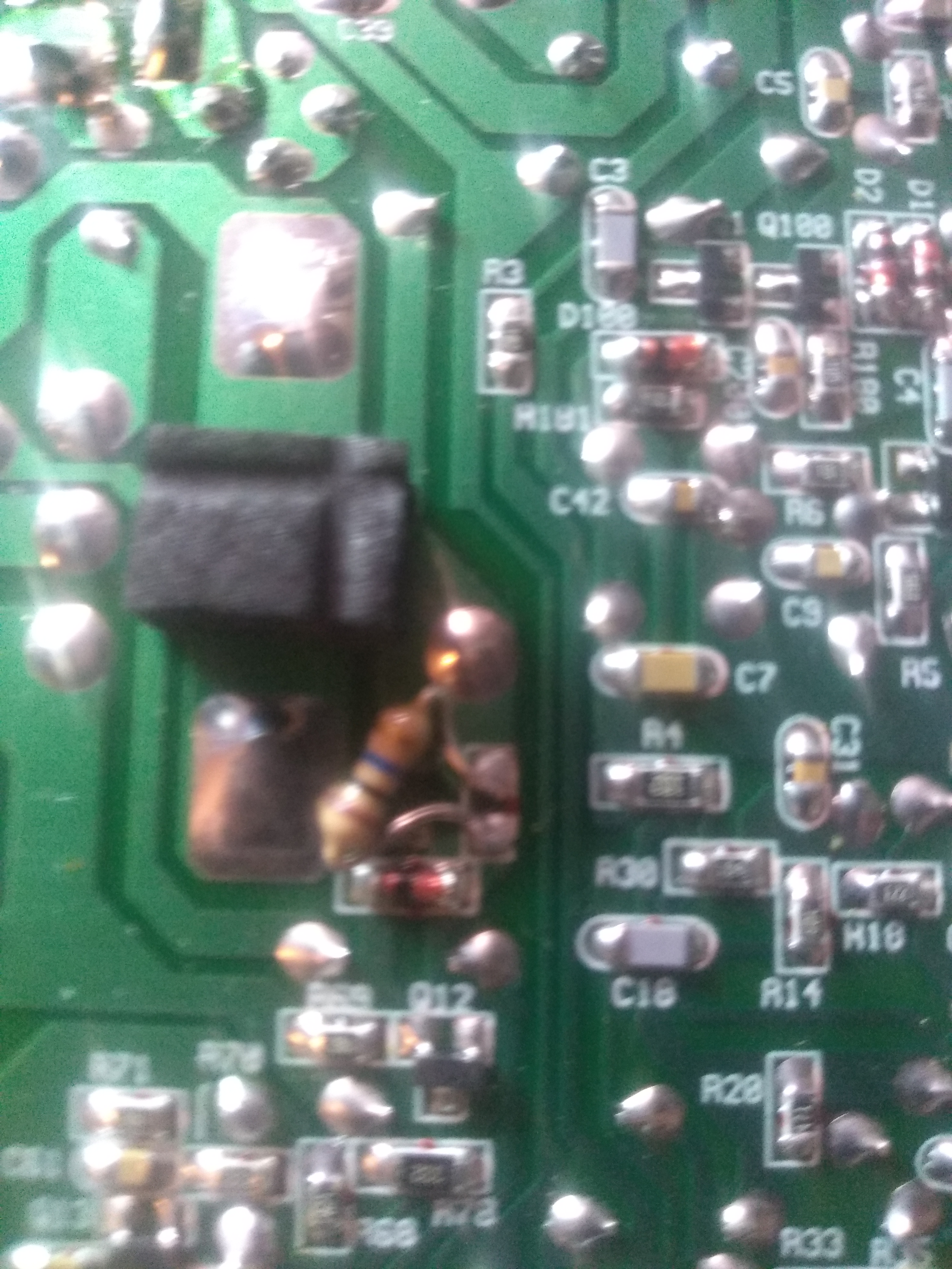

Starting this thread because I will be continuing some things on this radio which I'm sure a few of you have sitting in a closet or in the Attic somewhere. So let's just consider this the master thread for this radio.
I started tonight with the limiter. This is a must even if you decide not to do anything else to it:
Replace c60 with 4.7uf (release)
Replace r67 with 10m (threshold)
