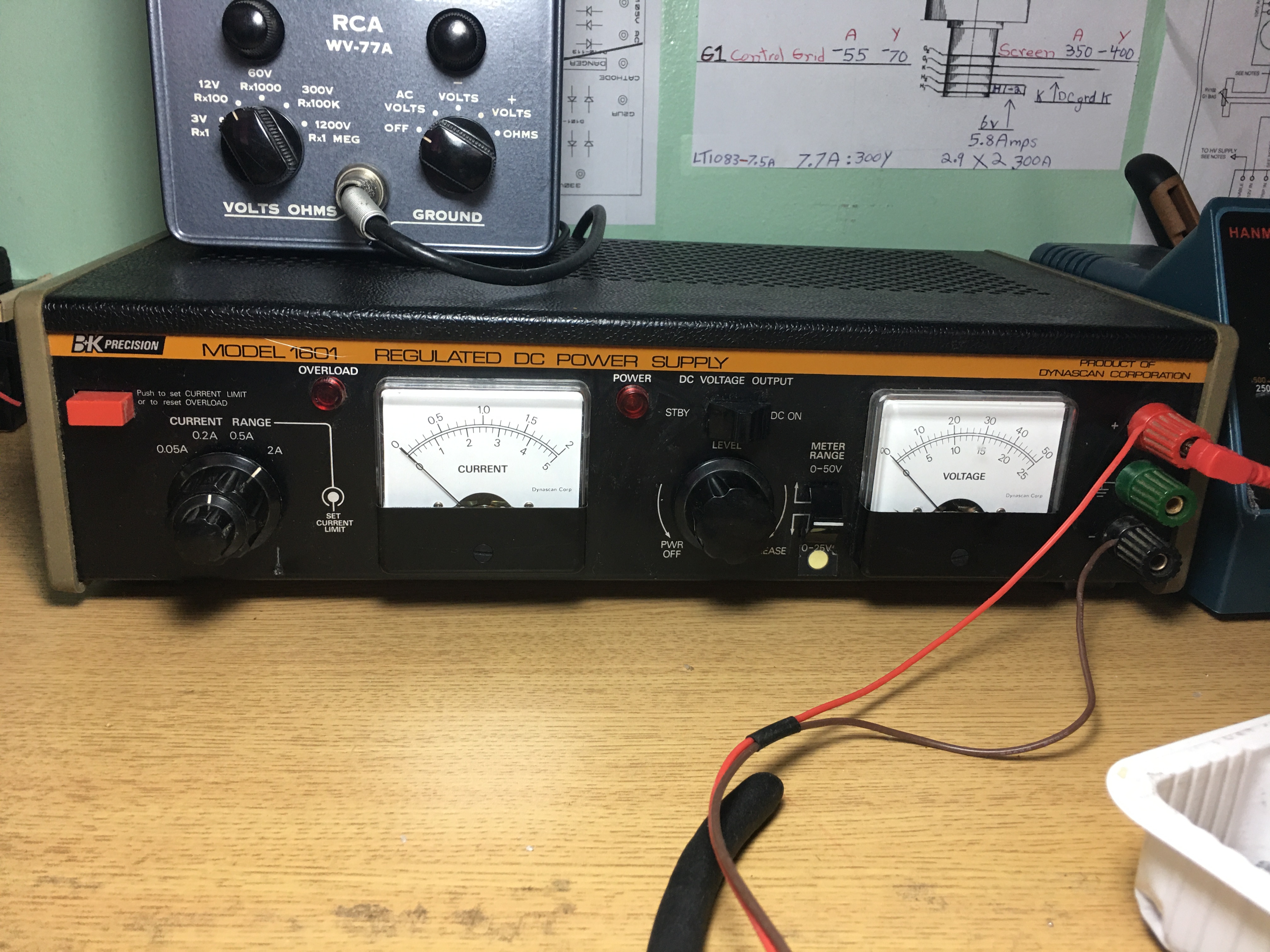

Got a new-to-me bench supply I recently got from eBay. It's a B&K 1601, 0-50v at 2A max with continuously adjustable current limiting. Late 1970's vintage but good cosmetics. I replaced all the caps and few things that needed it. After re-soldering some loose connections, the single 3055 went out so i replaced it w/ a 3772 (a real one) I've been hoarding. Anyway that got me started replacing caps on my Pwr supplies. When did electrolytics get so expensive? It's been awhile.
Reconditioning NOS caps, I'll let them sit for awhile.
