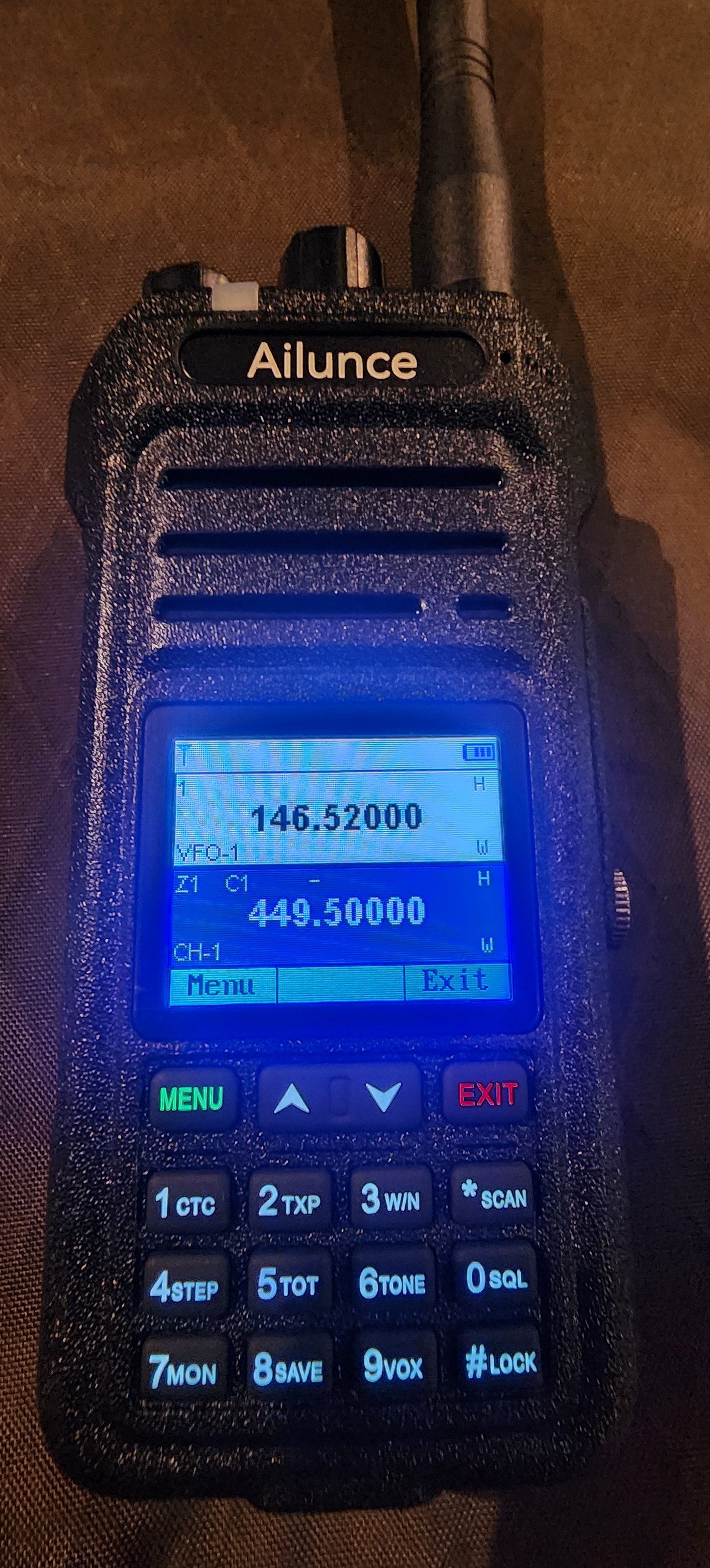

The Retevis Ailunce HA1UV is a dual band, VERY rugged IP67 rated 5 watt radio that is marketed toward the entry-level ham community, with a price of about $70 USD on Amazon. The general motif of the radio is much like a basic commercial radio - the 256 memories are organized into Zones and Channels. 64 Zones, each containing 19 memory channels and two additional VFOs (for band A and B). The VFOs allow you to punch in any frequency or repeater without needing to program a memory. When the radio receives a signal, the screen changes to bright green with a header that tells you which Band is active, an RSSI meter, and the Tone/Code programmed for the receive (if any). If no Tone/Code is programmed for RX, the display will say "No Code". Note, that "No Code" doesn't mean the transmission you're receiving is not transmitting a tone/code ; rather it's an indicator whether the HA1UV receive has a RX Tone/Code programmed which will only cause the squelch to open if that tone/code is detected.

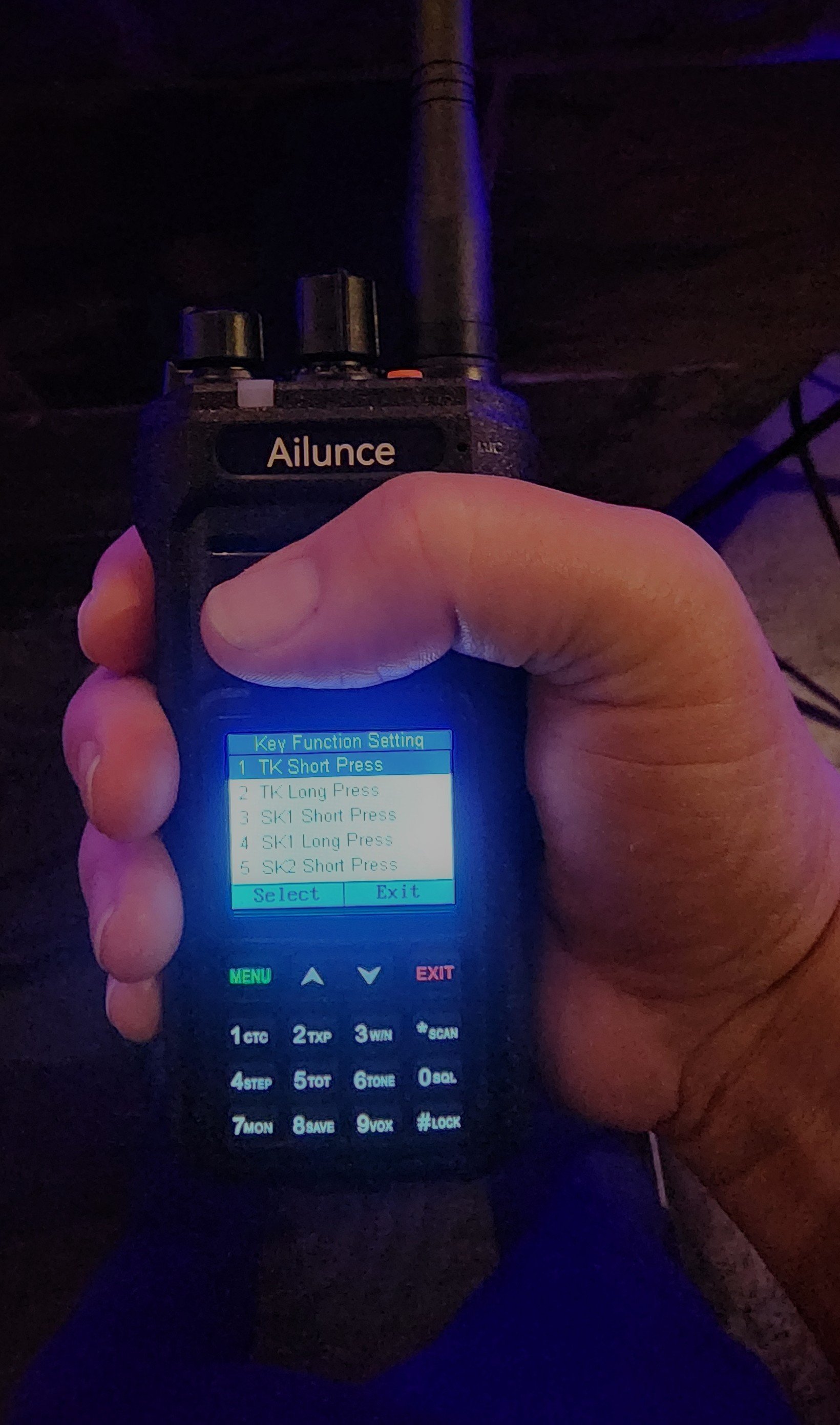

The HA1UV is a larger-sized radio and really does fit well in larger hands. I asked my wife with smaller hands to try it and she found it comfortable, as well. Here's a pic of me holding it at the local bar :)

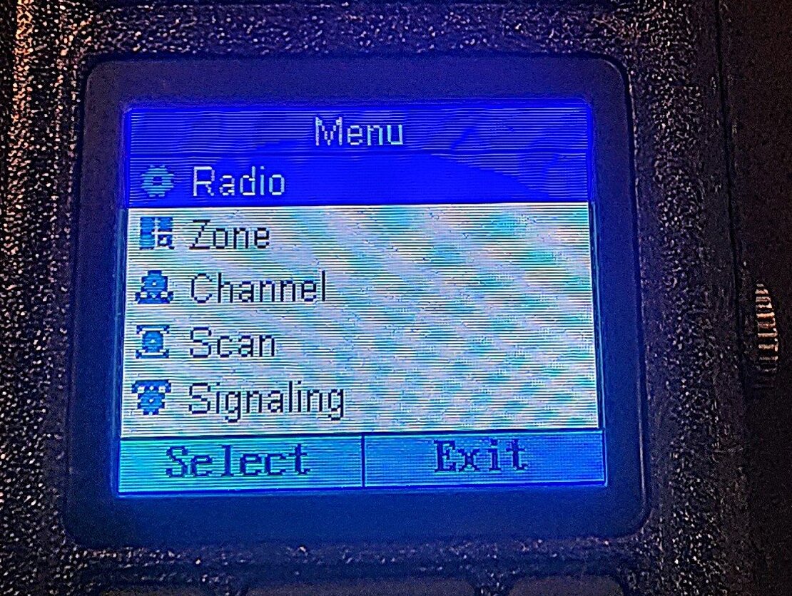

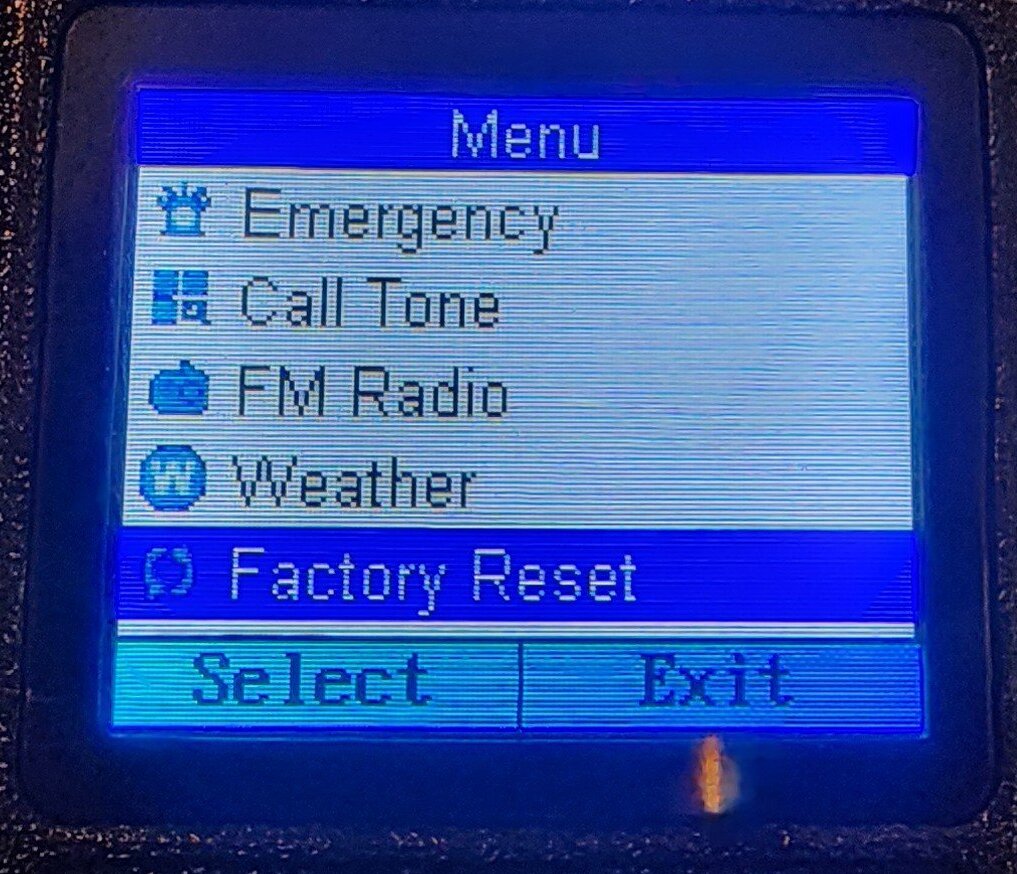

The menu system is very easy to read and understand. There are no cryptic abbreviations and the navigation just makes sense. Retevis also provides a brand new, polished CPS application for programming (more on that later) but it is really simple to program the channels and zones with just the radio. Here are a couple shots of the menus:

The color & brightness of the screen is one of the areas that could use some improvement, in my opinion. Inside and in the shade, the screen is plenty bright and easy to read. But in the sun or bright shade, it washes out much like a typical smartphone. Throughout my evaluation period, I provide a lot of feedback about the color combinations - originally most menus had black text on the blue bar, which was impossible to see. Retevis took the feedback and changed all of the dark blue menu selections to have white text, which is a huge improvement. While I was writing this, I just found another menu that was overlooked when updating the colors, which I will report.
The two side buttons (not the PTT) and the top orange button are programmable and you can assign about a dozen different functions to them. As of the time of this writing, Retevis' website says that you can program one of the buttons to do the sub-band PTT, but there is not menu setting to make it do that.

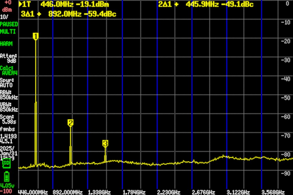

As I usually do, I hooked up the TinySA Ultra with a 40db attenuator and tested the harmonics with the radio set at 1 watt TX power. This is also an area that Retevis worked on throughout the beta process to ensure the HA1UV is as clean as possible. Here are the results:

Here are the tests for 440mhz:
full
The FCC doesn't publish specific measurements for 440 transmitters less than 25 watts but I generally like to see similar numbers as the specs for transmitters up to 225Mhz. In this case marker 2 is below the -40dbc requirement but that's still 61 microwatts if the radio is putting out 5 watts, which is a bit higher than the 225Mhz spec. But that's still pretty good compared to a lot of the inexpensive radios.
