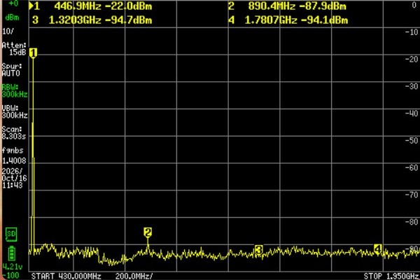

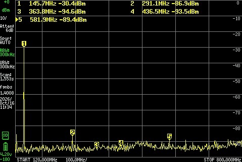

Tested harmonic supression with my TinySA Ultra.
