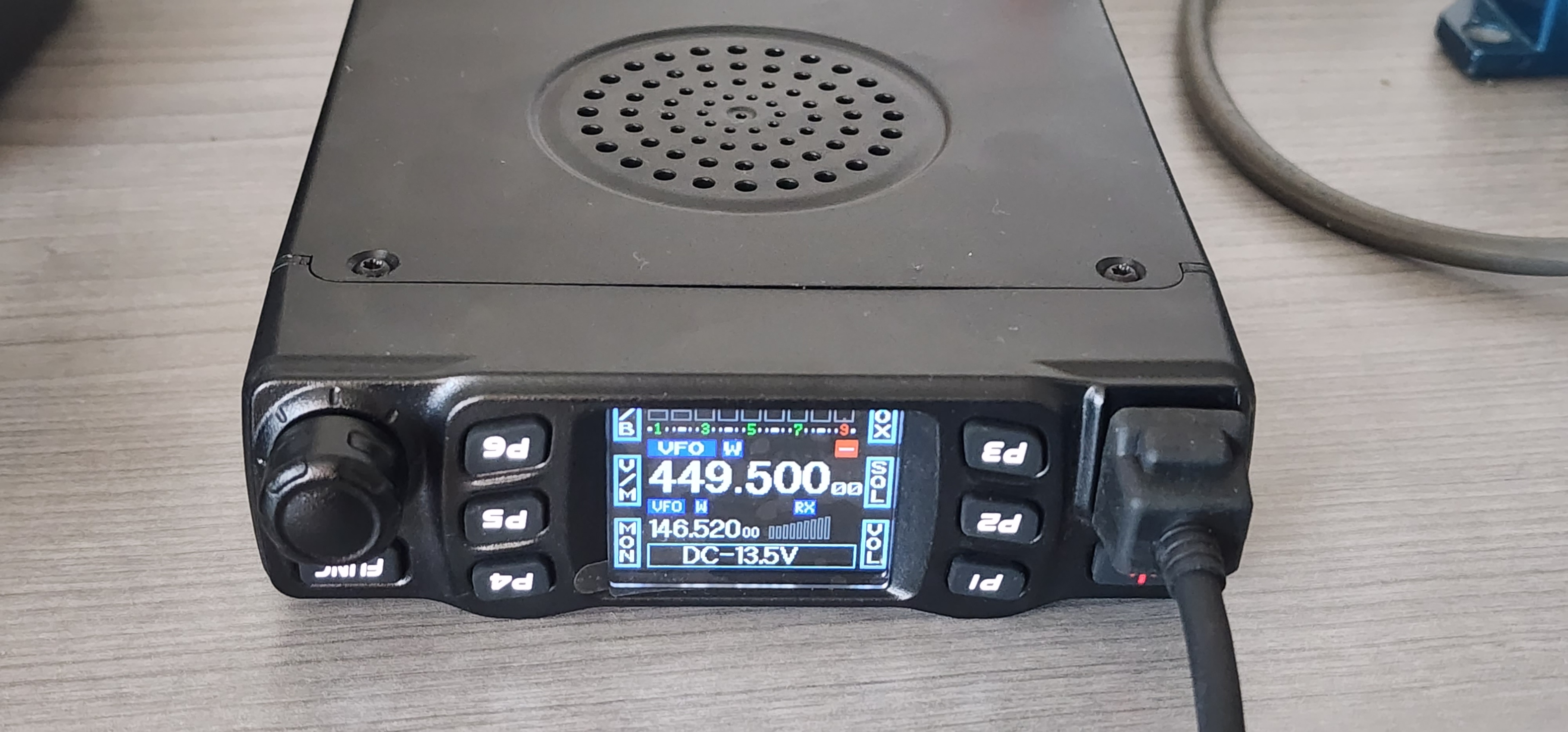

First, this mobile radio really is pretty small in size, but the screen is large enough to read clearly. Overall dimensions are 4.75" wide x 6.5" deep (including heat sink and main knob) x 1.5" tall. While it is small, I still wish the face plate was detachable like others on the market, but that would probably drive the price up. The mic buttons are backlit and large enough to also read easily. One interesting feature is that you can switch the audio output to the main speaker (radio body or external) and the mic, or both at the same time. Audio output from the main radio unit is nice and LOUD. Unfortunately there is no mic gain function.

One of the best features of this radio is the ability to flip the display upside down to suit mounting in either position so you can hear the speaker. For example, if you want to mount it overhead, keep the display in the normal position. If you want to mount it on the dash, flip the screen to make the speaker face up. In the flipped position, the main body buttons will be upside down (of course), but that really doesn't matter and only takes a minute to get used to.

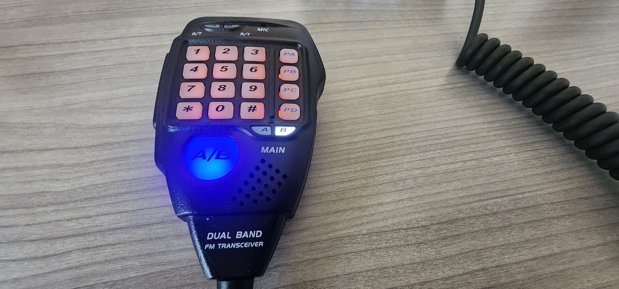

Another really good feature is the 10 programmable buttons: P1 to P6 on the main unit, and PA through PD on the mic can all be set to pretty much whatever function you want. The main P1-P6 buttons can each have two functions set: one by default and another activated when the FUNC button is pressed. That's a total of 16 programmable buttons! The main knob also has a press function that may be needed on several of the programmed functions. For example, while turning on CTCSS or DCS, you press in on the main dial to select the tone or code. While using the radio, a quick press on the main dial changes frequency precision, used while changing frequencies. A long press on the main dial locks the radio from accidental changes.

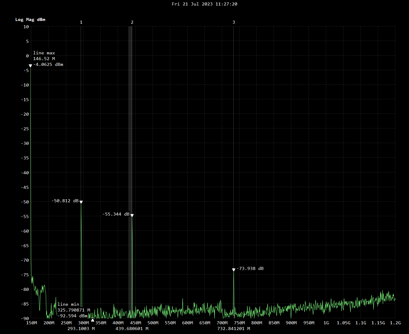

I hooked up the RT95 to a TinySA Ultra to observe the spectral purity on both bands. On each plot, markers have been placed at the major harmonics. Here's the first plot with a fundamental TX frequency at 146.52:

The results were a little better than I was expecting; both the 2nd and 3rd harmonic are below -50db. Keep in mind that the FCC specs for radios that transmit at these frequencies are -40db down and no more than 25 microwatts. So while the 3rd harmonic of the RT95 on 2 meters is -55db, if transmitting at 20 watts, it is still putting out 60 microwatts, which is well over the FCC requirement.

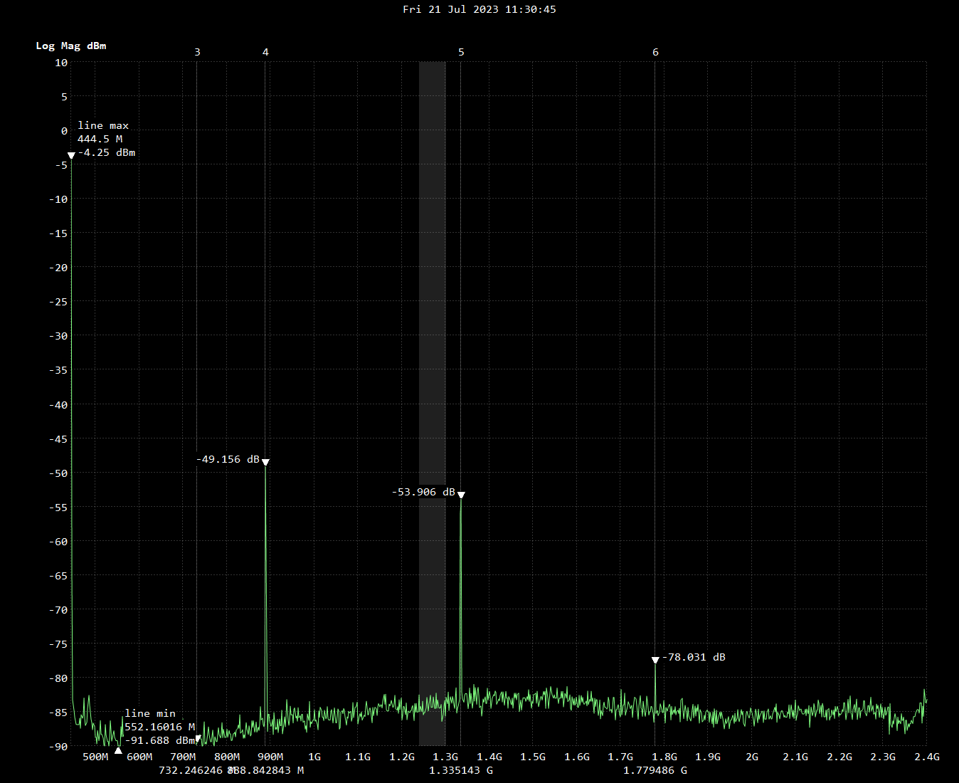

The spec analyzer plot for a fundamental 444.50Mhz transmissions produce similar results:
