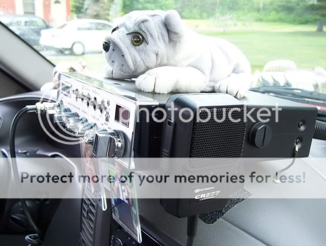

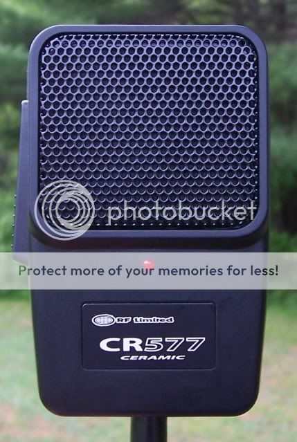

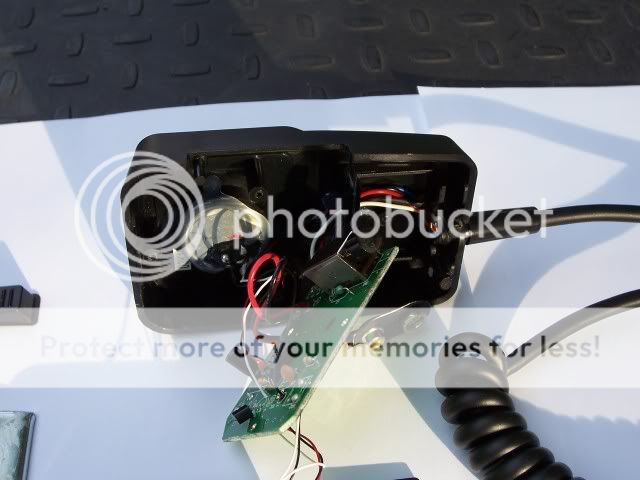

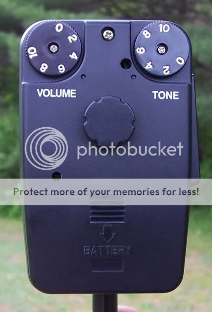

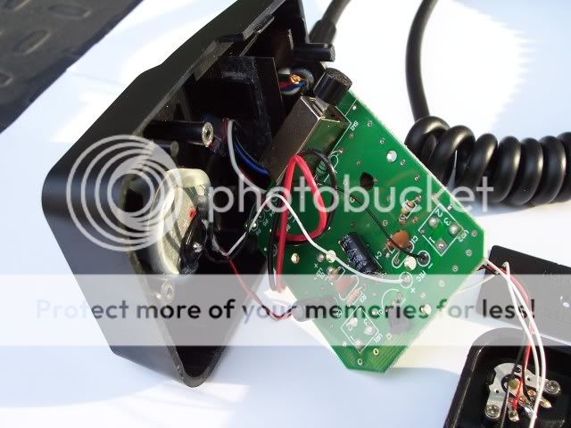

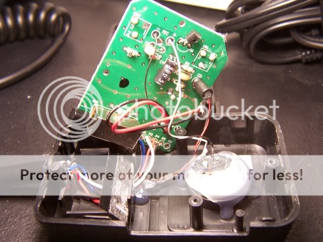

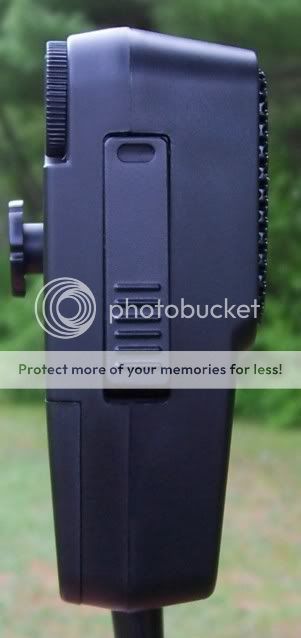

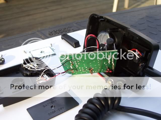

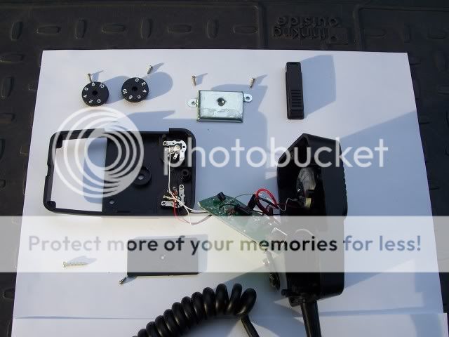

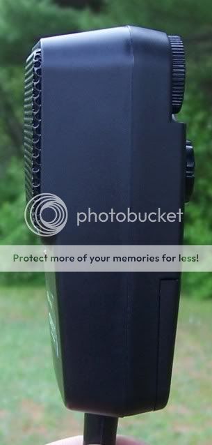

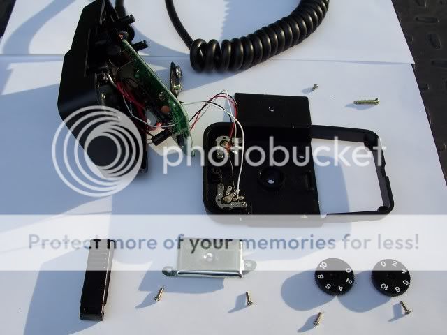

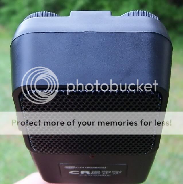

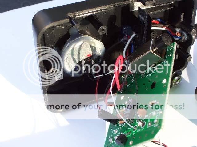

Bulldog's RF Limited CR577 Ceramic Microphone
I purchased a CR577 from Sparkys CB Shack. Wicked nice price of $47.95 but I think he has a limited stock of them. Here are some good close up pictures.
My Experiences On The CR577!
The CR577 is a real nice sounding microphone. Probably one of the very best. My girlfriend Country Girl remarked one day driving home from work, "sound pretty darn nice"! I have used the ceramic microphone on a new version Cobra 148 GTL & Cobra 29 LTD "Black Chrome" Edition. Both radios have swing kits and dead key about 2.5 watts and modulate to about 12-14 watts. Tested the CR577 against the Xtreme 2018 and Astatic D014-M6B. It edged out the Xtreme and way better than the Astatic! RF Limited has a real winner, but...
When I try to test this microphone one my other radios inside a hum/transformer noise can be heard in the background. Something like a rf leak of some sort. I have a Cobra 29 LTD "Army Strong" Edition hooked up to a Pyramid PS-12KX power supply. No matter what distance the microphone is away from the power supply it has that issue. I even located the power supply further from the radio but no difference. Hooked up a vehicle battery inside the house and still has the light hum. Rewired the microphone to my 28 year old Cobra 2000 GTL and was the same issue. In every case if I key up the microphone with one hand and touch the chassis with the other the hum would go away. On the Cobra 2000 GTL I had rf feedback. Touching the chassis stopped it. I tried all the little tricks to get rid of the hum but no luck. When I touched the chassis to stop the hum the microphone sounded choice. Hooked up through a custom echo box with a RF Limited Turbo echo board was unreal for sure!
In conclusion I called RF Limited and talked with Sam Lewis. He told me it will get fixed and send it to The Radio Shop. Chris Holland is the developer of this microphone. So off it went to California with a full discription of my tests and the issue with the hum/transformer noise. Can wait to get it back so I can continue my tests and start making those videos. I love making videos of myself.
