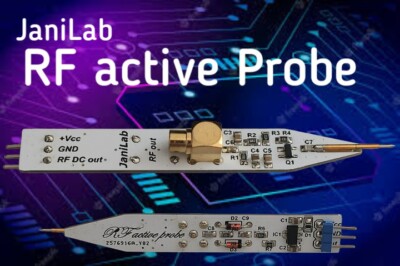

That's almost identical to the one I built, but it is worth noting that, as-is, that one has it's output -20dB down from the signal at the probe tip. That means if you build this and probe a signal at 500mV, what the FC sees is only at 50mV. Suddenly you are right back down where the FC wants to stop counting. I recommend connecting a signal generator to your FC and see exactly where it gets unstable, its a good number to be aware of. At least the output of that active probe is 50Ω and could be connected to the amp he already built (and get +12dB out). Edit(math error): so with a 500mV signal, you get 2v to the FC with that amp.
This write-up of the project talks about that gain issue.
You can buy one ready to be stuffed into a housing for $30. I remember when that active probe plan first dropped, there were a dozen people selling them and they were only $20. That didn't last long. I had a hard time finding that one.
I was wrong, they are still online for $12, just search for RF active probe. I searched for BF998 probe and got less results.

I just received the probes, but they have a strange connector on them. Looks like a push on, but my push on isn't exactly the right size, a little too small. Would you know what connector it is?
Also, this thing is tiny. I'm searching for a suitable enclosure. Do you think I should change that connector for something else?

I'm guessing those are MCX connectors. I think the connector you are looking for fits inside that one rather than over it.
I put the one I built in a piece of copper pipe and used two pipe caps with holes drilled in them for the ends.
Reactions: Cable Guy
Thanks for that, I see the mcx male end would be what I need. I should have one by Friday so that gives me time to work on the enclosure. I think I have the copper pipe already so, off to the workshop I go. Then to work on a power supply for it. I'm new to active probes and you have been most helpful. I see a RF DC out pin on the probe, is that just a rectified rf output? What would that be good for? I may have more questions later, assuming I'm not wearing the welcome out.
It might be worth removing the connector and going straight in with some coax. Fitting an adapter inside a tube with that board in the center of the housing tube will mean a larger than ideal diameter. I recently got some RG178 off amazon for my probe and I really like it. Its diameter is about that of pencil graphite and quite flexible. Having a heavy coax coming off the probe is a pain.
I would guess (based on the diodes on the back of the board) that RF DC out is is rectified RF. If you feed that into an audio amp, you should be able to hear the AM modulation of an RF signal which is a really nice for troubleshooting IF stages.
Edit: Calling that pin RF DC out instead of mod or audio out suggests that there may be a DC offset. Although it appears that C2 (from their low resolution image on the website) is in line with that pin, I cannot see the traces and cannot guarantee that. I assume it is decoupled audio, but its best to be sure before connecting things to it.
I have some rg316 I need to find a use for, it's kinda thin and sorta flexible. I can terminate it with bnc at the end of the enclosure or I could wire it direct into the amp. Couldn't the RF DC output be used as a relative signal strength into a volt meter?
