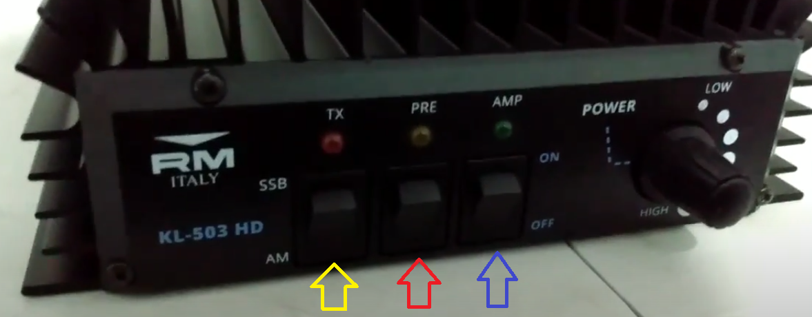

In order for the 503 to work correctly in modes, the thing is set up to be switched in between two type of inputs.
YELLOW ARROW
Hi-input - means it has carrier - so the power input would be too high for safely operating unless it's attenuated, that is the AM setting of the switch (AM/SSB) - what it is for...
RED ARROW
to help the user receive weaker signals...
Blue Arrow
turns on or off the amplifier (bypass)
That "cruncy" is from too much input into the wrong mode, or you'll have to install a dummy load resistor across the output of the radio to reduce the signal going into it from the radio but let's you hear from it.
May have to be a permanent fix install to do this...

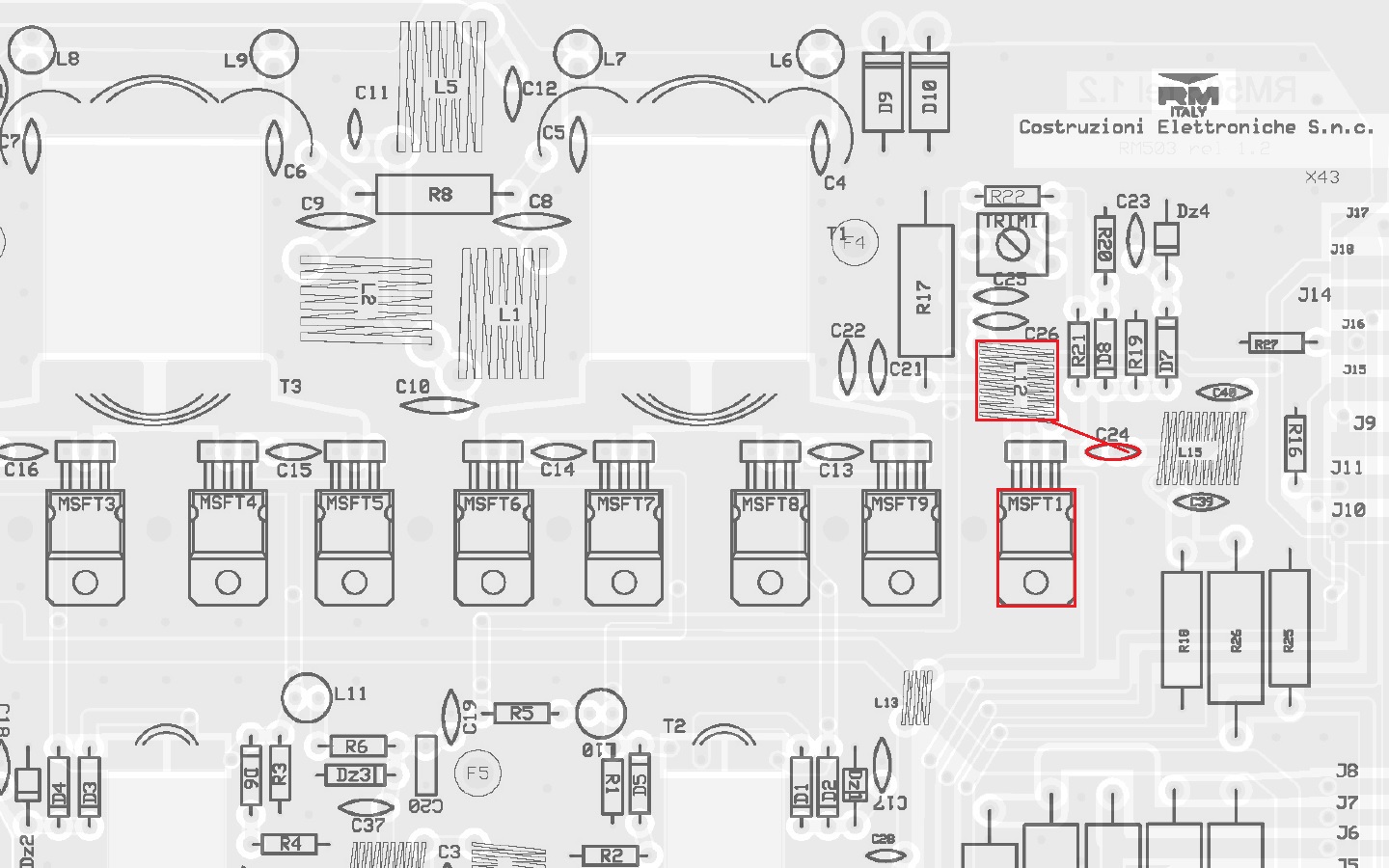

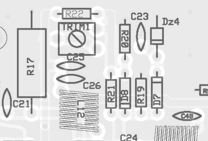

I was going to tell you to jumper this, remove that, etc... but it would be easier to just remove L12 (DC power input to the driver transistor), the driver transistor and C24, run a jumper wire from where C24 connects from L15, to L13. This will bypass the driver stage, and "should" work, might have an impedance mismatch, might not. I got out of repairing radios around 2000, long before the "pills" started drying up and they switched to MOSFET's.
There might be a closer part of that trace where L13 goes under the driver transistor, too hard to tell from their service manual and not having one here in front of me to eyeball.

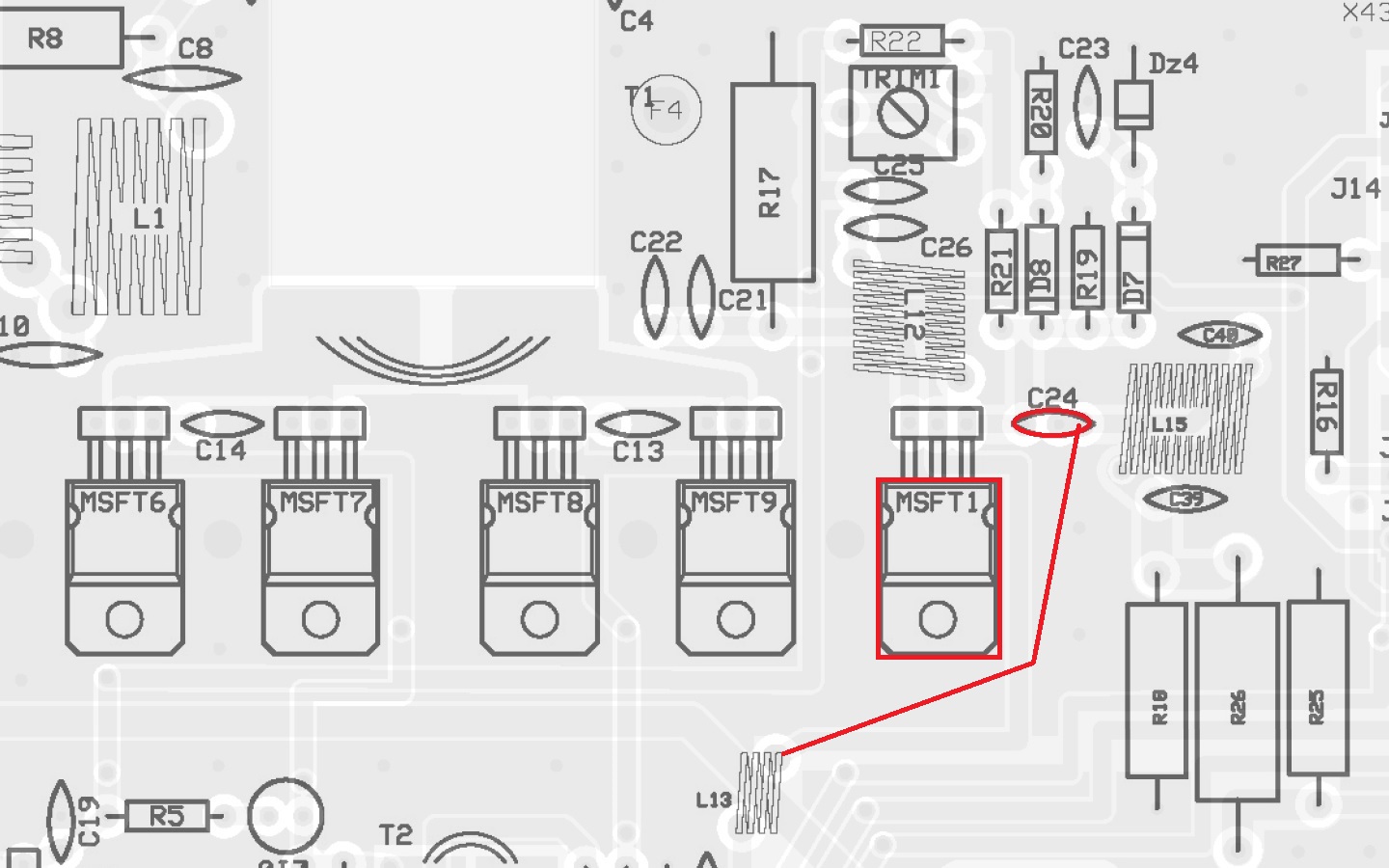

I looked at the schematics again, after pulling L12 and the Driver transistor, C24, run the jumper from where C24 connected to L15, to where you pulled L12, closest to the Driver, which is a shorter run.

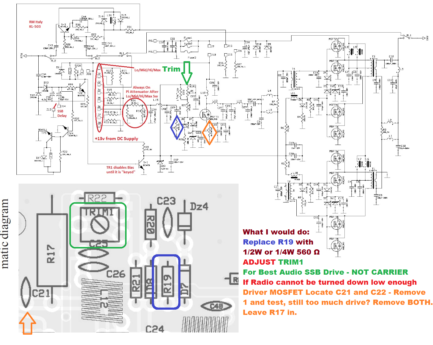

To help...
Augmenting NZ8N's ...
This is my approach to these amps...
But I will mention, you forgot to re-trim for the other radio that may not have enough drive level to offset the push the Driver needs in both SSB or AM modes - the "low-level cut" you experience is from a improper bias trim - here's some details:

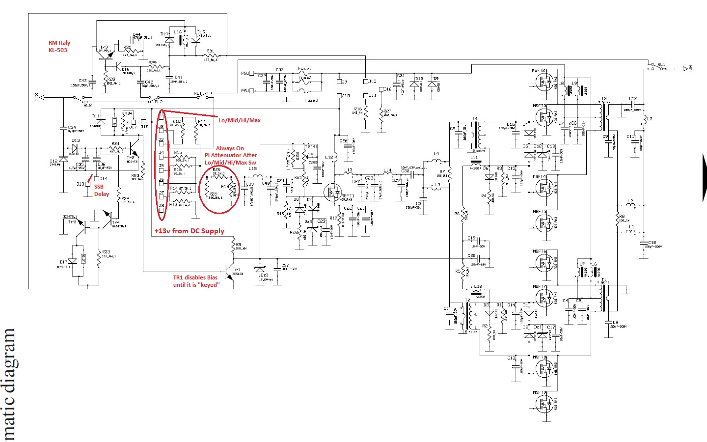

NZ8N's given us a better schematic to help you I dug up my notes...​
To help you, you adjust the amp in SSB mode using POWER trying to set level for best "audio drive"...
  • don't worry about "clarity" TRIM1 does that...later step...
This does mean you'll have to set power to a given "best results" setting - so when you adjust this amp - best to locate and "turn - dial in" the Power knob to find the best "run" setting - and this becomes your baseline.
The knob tells you how much input attenuation you are using - following the schematic above.
Once you know this setting - R19 is changed to offset this new drive level - only you REDUCE the OHMIC value of R19 - right now? I'd set it for 470 Ω YELLOW - VIOLET - BROWN. Wattage rating about 1/2 to 1/4W - whichever fits that R19 footprint - don't need a BIG sized resistor - the PI-filter attenuator took care of that wattage INPUT...you are trimming down the input signal dynamics - then you'll do a final TRIMMING to adjust the Dynamics of AM and SSB for best results.
  • There's tight clearance in there - so be cautious about the reassembly - if you wish, you can piggy back resistors ACROSS R19 to adjust and find the right ohmic values - R19 is a 6.8K resistor - so you have OHMS law on Parallel resistors working with you here.
This amp does use "Class C" but you trim to offset the C and AB effects you need to satisfy the user. To find the best trim point? Locate it's best guess on the POWER knob - then Using R19 - you find a value that let's you use this Best Setting on the HIGHEST POWER Setting on the POWER KNOB - you've reset the input of the amp to match more closely the radios output - and that will be your new MAX - changing R19 changes the INPUT level used for that DRIVER MOSFET.
Then raise/Adjust/Lower the R19 Ohmic resistor level to MEET that initial power setting curve - but on YOUR HIGHEST POWER setting.
You then (By Adjusting) TRIM this for best gain to Audio sound and drive quality once you're set R19 and POWER INPUT knob right. Trim handles the lower end setting of the dynamic range - then you can go all the way up on the POWER KNOB for the PEAK dynamics and the TRIM takes care of the lower Drive levels.
Now, I also know that some wildly swinging radios - like Galaxy, when turned down swing really well but too much in dynamic range for the input of this type of amp - that is where I mention the C21 and C22 removals - this gives you the range of signal RF drive above and beyond what R17 power load resistor does, when you remove one - YOU REDUCE DRIVE (stage gain) by a given amount - remove both, and you're at the LEAST GAIN of the stage can provide. This becomes your parachute if you needed to reduce the drive and swing ratios to make the amp sound better and swing tracks closer to the radios' own output.
NZ8N didn't want to go into details, I don't want to either, but the places I worked with push these amps onto the unsuspecting buyer - so they get wattage, but not the HIGHEST wattage - but they get the better sound because of the board supports this thru the TRIM on the DRIVER.
IF you run into problems.
STOP - take a pic or two and post your situation - we can help you thru this - best to go slow and If you have ANY hiccup - supply us with a view of what you're up against so we can guide you.
