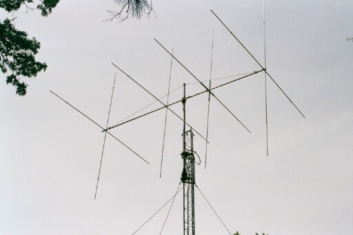

View attachment 27515 I made a hazer for my Rohn 25 I bought a Yaesu rotor thrust bearing and my 100.00 rotor has worked for almost 2 years. A bearing is well worth the price paid to save a rotor. I have a 4 element Maco flat side and an IMAX on top. Works great.in case your wondering the hazer rides up and down the tower with a winch and cable.

I would NEVER use a rotator rated for 5 sq. ft. with an antenna system of 5 sq.ft. No headroom whatsoever and one step away from failure. I had a CDE rotator ( bought out by Hygain) rated for 7.5 sq. ft and used it with an antenna system approaching that and broke two ring gears over the years. It was properly mounted inside the tower with a thrust bearing at the top. It was the wind that tried to rotate the rotator that broke the gears. Now I am looking at installing approximately 22 sq. feet of antennas and have a Yaesu G-2800DXA rotator rated for 32 sq. ft. I feel better about this.

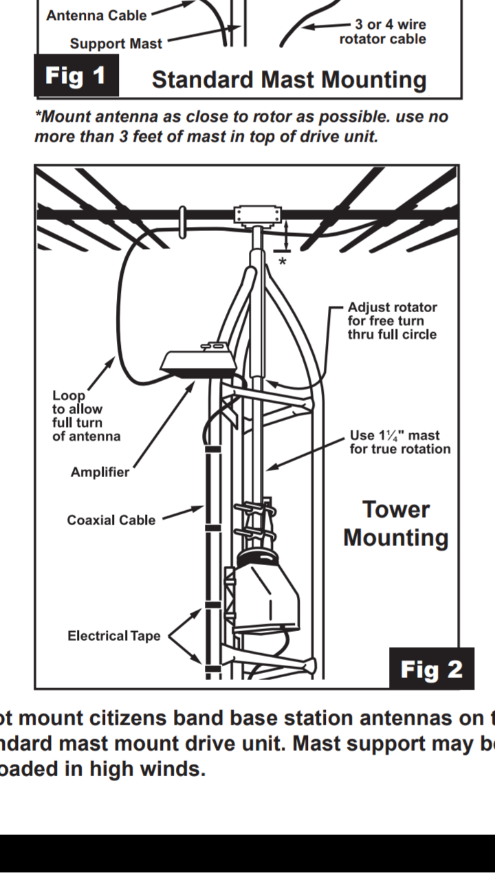

Apparently the 9521A can take a 2" mast and the HD only 1 3/4" max mast..
I didn't realize these models attach to the side of the tower and self center.. from 9521A installation..
