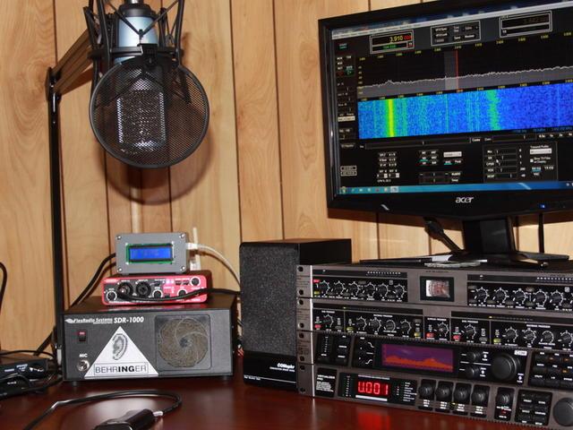

I now have the Edirol FA66 sound card and it made a world of difference on what you can see. I am starting to dabble in the black art of eSSB and having alot of fun learning about all the audio stuff.
I could use some help with the Behringer DEQ-2496, this is an awesome piece of gear but a bit overwhelming for a Noob like myself. I think I have a decent base set up but I know I am leaving alot of the table.
Set up is as follows
Mic: AKG Perception 220 Condenser Mic
Behringer Tube UltraGain MIC200 ( soon to be replaced with the MIC2200 )
Behringer UltraCurve DEQ-2496
And that all feeds the SDR-1000 with FA66 Sound card.
I had to go back to version 1.18.6 software as the 2.0 stuff is too buggy for my liking.
Would love to get some audio reports and possibly some help with the DEQ-2496, this stuff is really addicting and is making me LEARN !

Mic is a nice choice.
Definitely get the Behringer 2200; I use one too. Best bang-fer-buck - IMO.
I have a DEQ2496 too...
As far as the DEQ unit, just start using the parametric EQ function first. The learning curve for parametric EQ's isn't that hard; Google is your friend here. Graphic EQ's - as opposed to parametric EQ's - can be used. But they can pull unwanted/adjacent audio freq's out of phase. Studios don't use graphic EQ's; they use parametrics for that reason.
You can split the channels into two separate units in the DEQ; don't run it in mono. This way, you can use the parametric EQ from one channel and then run the output back into the second channel input for using it for just compression. I would set up the compressor as a 'limiter'. Those 'limiter' settings can be found on Google. Limiter settings are fairly generic and are a fair starting point.
Watch the output gain in each part of the audio chain - and make sure that you keep your wiring in a balanced configuration. As this helps keeps out stray RF. Get some snap-on type ferrite beads and put one on each cable in the entire audio chain. This will really clean it all up and is highly recommended to do - if done correctly. Keep the lengths between the rack gear as short as possible - about 3 ft each is fine. Use Canare or Mogami cabling for best results because the shielding is better; I use Mogami. Belden is OK too; just not high-end studio grade . . .
That is, if you really want to get your eSSB groove on . . .

That explains what I first said.
Need to clarify my previous post further.
Since it becomes TWO separate units w/o any internal linking; you run each one using different functions. Let one channel be the parametric EQ; and the other a compressor set to limiter type settings.
Mic preamp line out into the DEQ. Take the output of one of the channels ("Line Out") and bring it into the Line Input of the other channel. Line out of the DEQ and into the radio.
Mic
Mic Preamp
DEQ 1st channel - Parametric EQ
DEQ 2nd channel - Compressor/Limiter.

Finally finished the Audio Rack build up for the SDR-1000. It sounds awesome with the external audio gear, on eSSB is where you really hear it at 5k wide. Of course you have to be able to hear 5k wide to really appreciate it.
So here is the final rack build up.
MIC-2200
DEQ2496
EX-3200
SDP2024P
All of the rack gear is Behringer.
