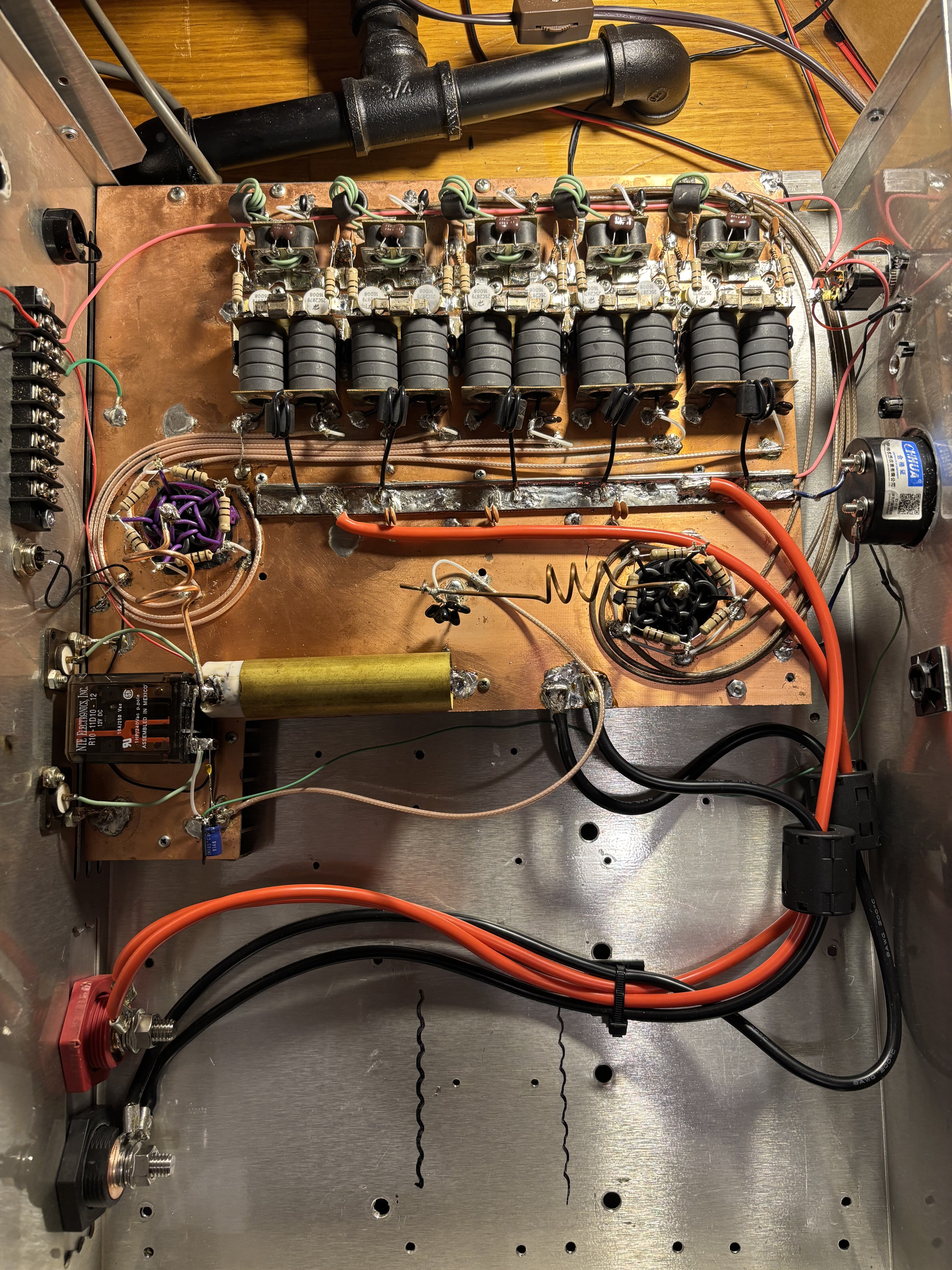

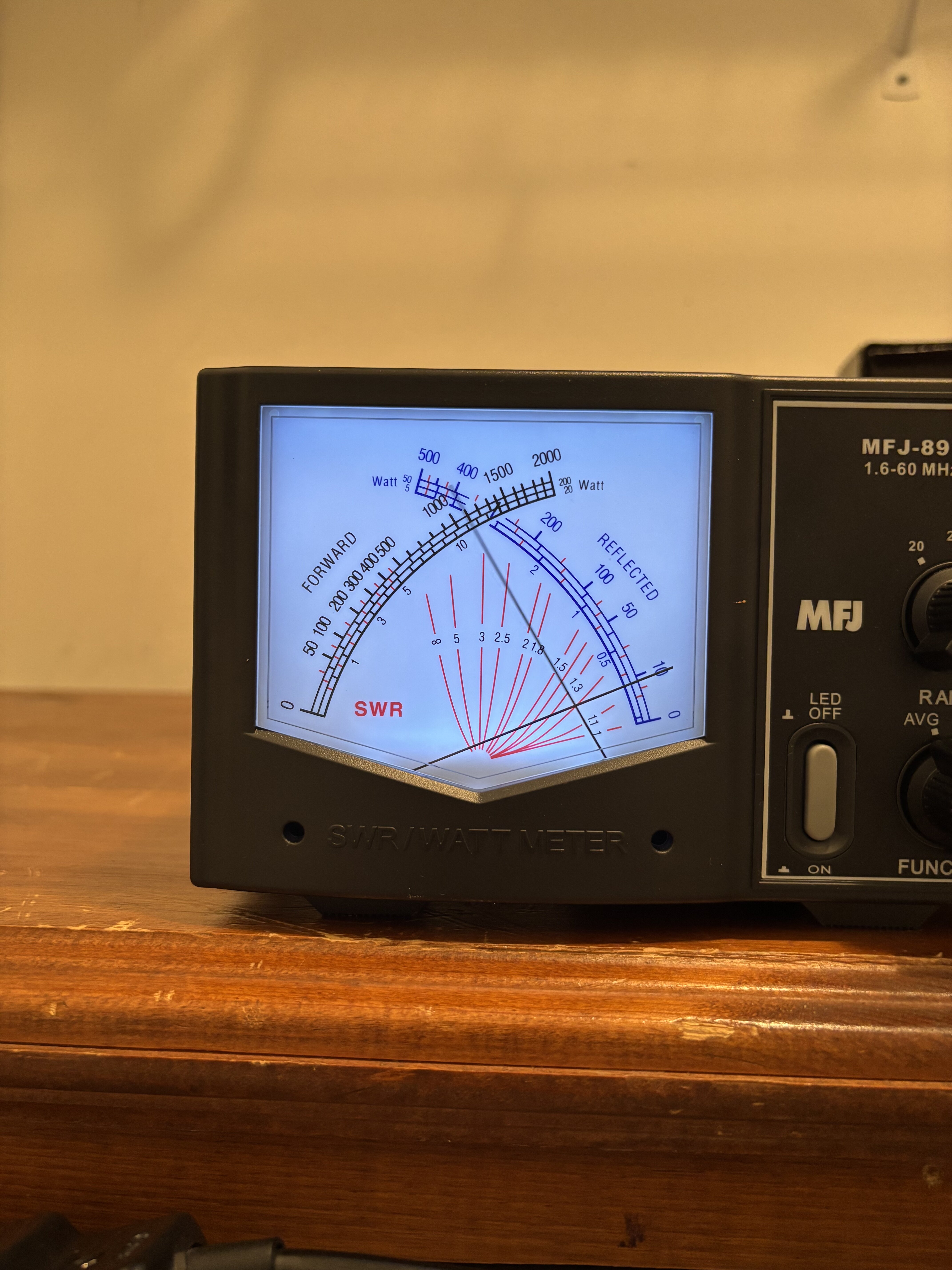

It’s a XForce straight 10 pill. That burned completely up. I replaced all the pills from Toshiba 2879 red dot with hg 2879 16DO8 matched. Tested all the caps replaced one bad one on an output transformer. New mini coax, new 5 Port combiners/splitters. All new resistors throughout. All matched. I don’t have a dummy load to test with but my antenna has a 1.3 SWR on my other amps. This one come back up with low output and a high SWR of 2.75. It had a 2 turn inductor from output combiner to relay. I played around with different turn and diameter coil. It now has less that 1 full turn It is matching what my other amps show now. The power seems a bit lower on the output wattage. Driving it with a two pill driver dead key 30 watts and swinging around 100 peek. And I see 80 watt dead key out and swings about 850 max. I’m novice and trying to learn. I have a few of my original Toshibas that’s still test ok. I want to use those and experiment with building a 4 pill for my self. After I get this worked out. I’ll post some before and after photos when I get time.

I managed to get this job completed. Photos is completed results. Turns out I was chasing a bad coax and meter. Go figure. Probably what popped the pills originally. But my goal is to understand how to do input/output tuning. On amplifiers of this design.
