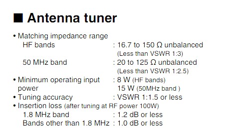

Here are the internal tuner specs from the 7410 manual.
That's about a 3:1 range. (16-150 ohms)
The G90 specs says it matches 5:1 (about 10 to 250 ohms)
