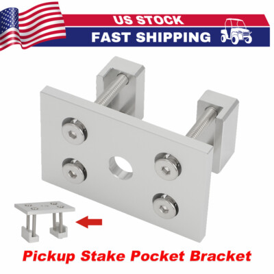

Planning an install in the new Silverado. I decided again drilling a hole in the roof. Not a huge fan of magnet mounts for permanent installation. Planning on installing a front fender under the hood style mount for vhf/uhf. This leads me down the stake pocket road for a 10/11 meter antenna. My plan is to use the rear pocket. I don't want to jam an antenna directly behind my cab. Although I've never ran an antenna directly behind my cab, I can't see how this would be ideal with reflection off the cab. This led me to want to use the rear pocket. My first go to was Breedlove. I emailed them and they advised I go with the 900 or 920 model. These have the long plate that puts the mount off the edge of the bed rail. Screenshot_20250817_152750_Samsung Internet.jpg
I really want to avoid this look. I want one that sits down inside my pocket or just on top not a plate hanging off the side of the truck.
After more digging I came across exactly what I was looking for from geotools. Below is a pic of what I want. Screenshot_20250817_154950_Samsung Internet.jpgThe problem is I can't get the guy to contact me back to order?? Does anyone have any other ideas or sources for what I'm looking for?

I believe he recommended those models because of the deep wedge design. The standard plate with the 2 catches that grab the inside of the pocket won't work from what I measured. The models you linked are the same build style as the breedlove 910 or 930. These would probably work on the front pockets but not the rear.
I have a plan to adapt a firestik mount to sit down in the rear pocket. Im going to experiment this weekend when things slow down around here. I will update if it works out.
