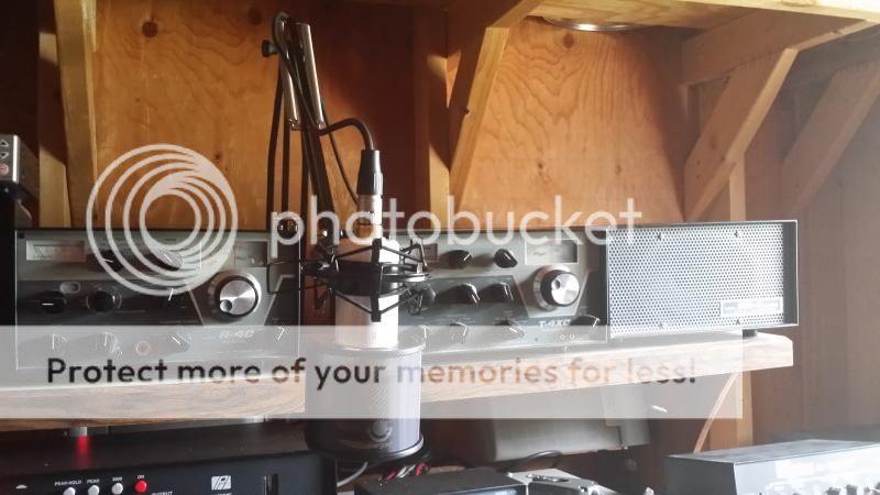

I use an OC White ProBoom and really like it. Fiddled around with a converted lamp boom for a while and liked it a lot (especially since I scored it for free), but my latest setup was too heavy for it. This one will hold about 5 pounds worth of spyder mount/mic/pop filter. The springs don't "boing" and the boom is silent when you move it.

Great looking station Brett, thanks for the reply :)
