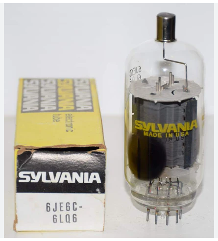

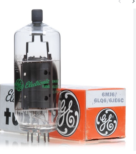

Sylvania and rca had real good tubes. And to break the news to ya, all the tubes were made by the same manufacturers and then branded. Slightly different build specs but thats it.
What you say about the same manufacturer may be true, but the "slightly different" build specs ... not so much.
- 399
You don't really know who made a tube until you can get a detailed look at it. The brightly-colored brand name and logo are not applied to the tube on the assembly line. Just the indelible (you hope) type number, maybe a date and/or batch code.
The factories would ship the blank tubes in egg-crate cartons of one gross, 12 rows of 12 columns.
Every company that owned a factory also had a sales division. Kinda like car companies. You don't buy a car directly from the factory. It still has to come by way of a sales representative of some kind. Even if you buy a fleet, it goes through a sales division that's not part of the factory.
Same deal with tubes. A separate business unit prints your brand name on the tubes from your factory and on the individual sales cartons that hold just one tube. But what do you do when your warehouse stock runs out? If the factory had that type number scheduled to make them in time you get them from your own factory and your customers are happy.
If they tell you it's gonna be six weeks before the next batch of 6L6GC tubes you buy them on the open market, kinda like crude oil. A broker finds those unbranded bulk tubes from some other factory. You print your name on them, and on the cartons you pack them into. You fill the orders your distributors placed with you and all is well. A sales company doesn't make money by telling customers to wait six weeks.
This is where that connection gets broken, between the maker of a tube and the brand name printed on it.
Some brands continued their sales divisions years after closing their tube factory. Raytheon is a company that still exists, even though it hasn't sold a consumer product of any kind in decades. When their tube factory closed up, their sales division carried on for years, printing that name on tubes made by someone, anyone else.
Long after Westinghouse had made their last tube, their name and logo would still appear on cartons and tubes sold by a company called Elmira Electronics. They were strictly a sales outfit, located strangely enough in Elmira New York. This was a license deal of some sort, to use the Westinghouse name on stuff that had nothing to do with that company.
D&A took advantage of a promotion tool that other folks have used. If you buy enough of an item, they'll print whatever name and part number you like on it. The D&A "D50" tubes were 6MJ6 upgraded sweep tubes. Not sure who the source was.
The collection of type numbers on the tube in the pics above is a whole separate story of upgrades and lawsuits.
