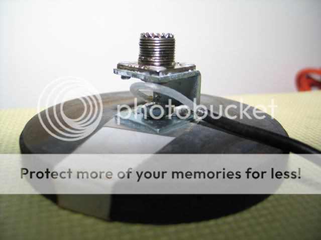

Here's the close up of what I did to revive my rather old 1000 Mag mount.
Spare K40 magnet with good foil to base of magnet, crimp terminal for new ground from coax.
Greg
