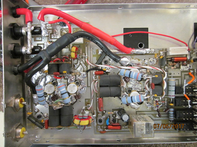

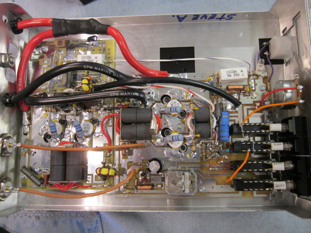

Why would a person eliminate the fuse holders out of an amplifier? Will the fuse be installed elsewhere in the power line?
~Cheers~
The Texas Star 500's and 667's amplifiers have a couple of fuse holders installed into the back of the chassis. These need to be removed to make room for a proper power supply wire upgrade internally.
Generally, I install an inline MAXI FUSE fuse holder in the positive power wire lead about 12" ~ 18" outside the chassis.
Or at the battery if mobile mounted.
Here is a photo of a power wire upgrade with fuse holders removed.
Here is a photo of a power wire upgrade with fuse holders still in place. Not easy to do with holders still in place.

Gotcha, it's good that the fuse is still installed (just elsewhere). That had me worried.... no fuse inline is asking for trouble. Thanks for the clarification. :)
