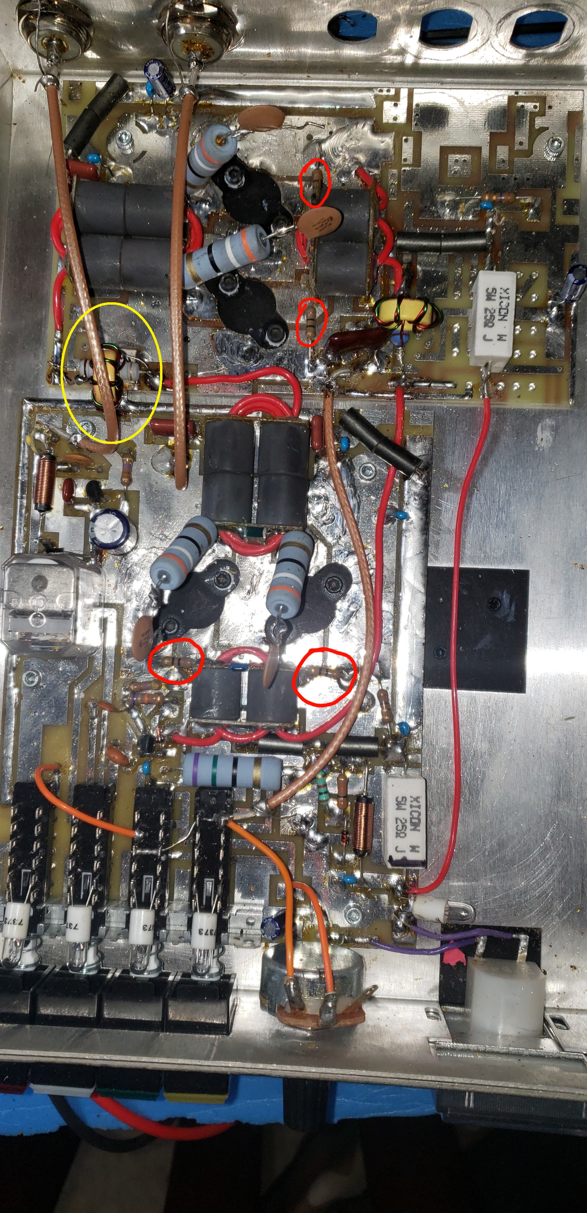

If R18 and R19 are burnt, scorched or otherwise discolored, that means the 2 power transistors associated with them (Q4-Q5) are bad and will need replacing.
This is my 500V after a temper tantrum.... If any of the resistors in the red circles are discolored, the power transistor corresponding with it is most likely blown. Also, take a good look at the resistor in the yellow circle and make sure it's not burnt, that usually only happens when you drive it into nuclear meltdown though.
The 2 resistors at front of the amp in red circles, R18 and R19 I believe are slightly burnt on one end each. It would be much quicker and easier to replace these two and see what happens before replacing all the power transistors. What do you think about trying this first. They would still require replacement if the power transistors need to be replaced also.
If they are indeed burnt, replacing them only, would be a waste of 2 resistors as they would burn out almost immediately. The sole purpose of those 2 resistors is a visual indicator that the power transistors have failed. You would only "need" to replace 2 transistors to get it operational but if you have the disposable income to replace all 4, that would be ideal. Are they DEI transistors or an older box with Toshibas?
Toshibas. So the best thing to do is replace the resistors and put in 4 new matching transistors?
Well, I HATE to hear they are Toshibas, those things are ridiculously high now, $200+ ea. and don't be fooled by the ones on eBay, they're fake. To replace them with HGs requires having the input and output retuned as they are not direct replacements.
For the price of 2 Toshibas you can almost buy a new 500V.

I have HEARD and its been said the HG2879C is closer to the Toshiba part still not a direct replacement though. Again others with more expertise can judge that.

R16 and R23 , 1.8 ohm bias resistors, could also be bad, one or both, and not appear to be by looking at them.
I have seen that happen numerous times also.
At this point though, sounds like the keying transistor is bad.
Not the C version, its the regular HG 2879 16D08 that tune wise are the closest to the toshiba 2879's. They aren't a perfect tune match but close enough for government work lol.
As was said DO NOT BUY THE CHINESE FAKES. Lots of fake toshibas out there and no real ones to be found unless you know some one who has a private stash and then good luck getting them to sell some.
You could replace with used toshibas with close matching gains. Used toshibas run about $100/pill. If it were mine and i didnt have any used toshibas to put in it id replace with HG 2879 16D08 pills for $40/pill and run it till it smokes again, wash, rinse, repeat lol.
Before doing any of that id need to know what caused the pills to smoke and fix that also if need be.

How old is this amp? Did you buy it new? The newest Texas Star amplifiers (the ones they are selling now) I am pretty sure come with the Fake Toshiba's already in them. The regular HG 2SC2879 (not the C version) will replace those, however if they've changed the tuning to accommodate the Fake Toshiba transistors in any way, that will have to be put back like original old school DX500 before it will work right.

TS used the fake ebay toshibas for about a year before they were caught and exposed. Now they're back to using the may-pop DEI's.
