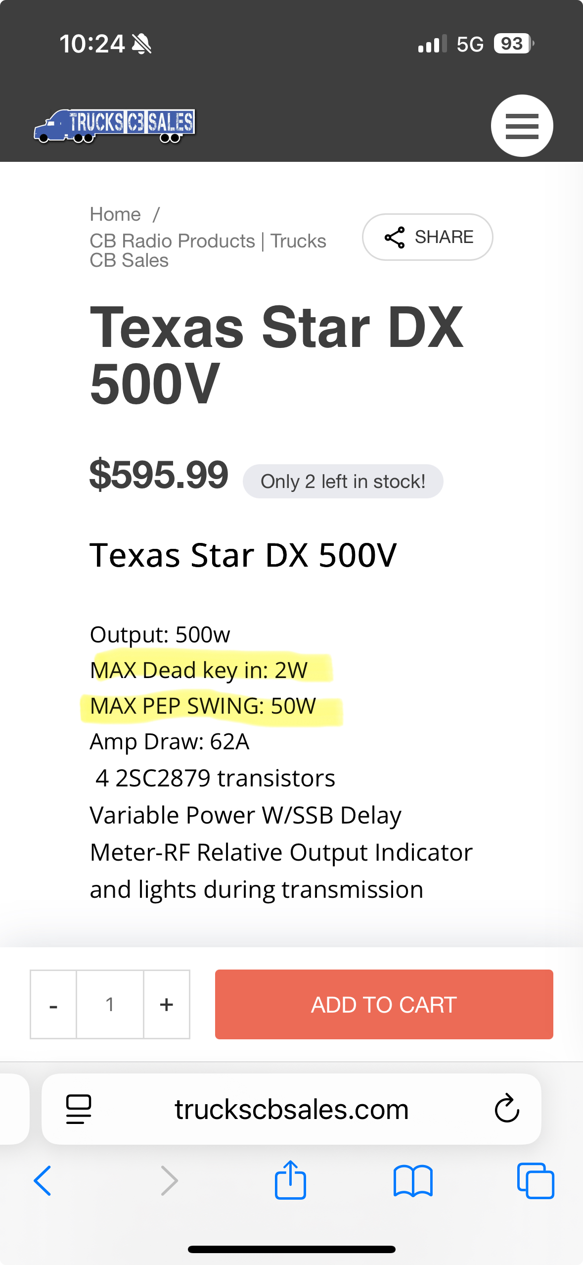

This is what I found in Google. If that amp has HG pills, I think it’s lower PEP. Maybe somebody knows that info.
Yes that is a new version with HG finals. That is a very steep price. For that kind of money I would just have one built below. Just add the class B bias and SSB delay, still cost less and comes with a fan.
