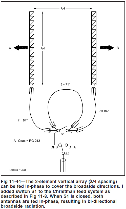

Also has anyone ever made a directional vertical beam from whips i saw a diagram where they stage the antennas 1/4 wave apart and delay one if them by 1/4 of a cycle creating a null on one side and a coincidence on the other. My thought was using a 102 to be the front of the beam and delayed antenna and a 108 for the back antenna. What would it take to make this work? I think ive got the idea right but my execution needs refined. If someone has modeling software dont be shy show off please lol curious to see if it creates goods gains for 11m

https://www.classicinternational.eu/_clientfiles/info_extra/hygainphasedverticals.pdf
This is pretty cool @BJ radionut so does this show an antenna with two ways of txrx such as a single omnidirectional and then switching to a delay to make the beam? Or array?
