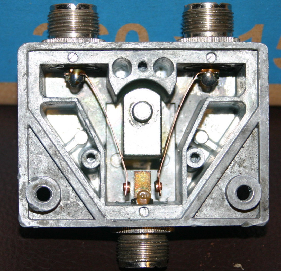

As a note, beware that some cheap switches are nothing more than a single pole double throw toggle switch and are crap. The better switches are housed in a metal box and is not a simple toggle switch and look like this inside. This is the Diawa CS-201 switch.
Yeah; the one I have/use looks just like the one you have on the inside. No doubt just re-branded and re-packaged. But they are really built quite strong. Took mine apart and cleaned the switch and put some decent grease on the ball bearing/moving block ass'y.
I'd buy another if I needed one, as the fair price and decent quality are both there - IMO.
Yeah; the one I have/use looks just like the one you have on the inside. No doubt just re-branded and re-packaged. But they are really built quite strong. Took mine apart and cleaned the switch and put some decent grease on the ball bearing/moving block ass'y (circled).

This is the spec sheet for the MFJ switch that Robb recommends. They claim that the switch has an impedance of 50 ohms. I don't understand this, as I see nothing resistive, capacitive or inductive about it. Can anyone explain how the impedance of this switch is caalculated ???

Eh? If you are asking me - wouldn't have a clue. Perhaps MFJ's technical writer didn't have his morning coffee? Either way, if it is a Daiwa or re-badged for MFJ, it is still the same box. It really is built very solid. The box is of course a machined casting; not a lightweight switch in a p-box whatsoever. But for the price it surely beats the crap out of those really cheap CB antenna switches - which have so little separation and poor insulation they really should be embarrassed to put their logo on it. For ~$20, it kicks the crap out of the competition. Now, that is a recommendation.

Perhaps the silver plated straps inside the formed metal pathways present a characteristic impedance of 50 ohms just like coax cable does. Perhaps it was tested with a VNA. The most likely answer however is that since MFJ knew it would be used in a 50 ohm system and since the impedance bump it created is not too bad (similar to PL-259's creating an impedance bum) they simply threw bullshit to the wind and called it a 50 ohm switch. :laugh:

I agree 100%, Robb. I wasn't questioning the quality of the item, just the 50 ohm impedance spec.
