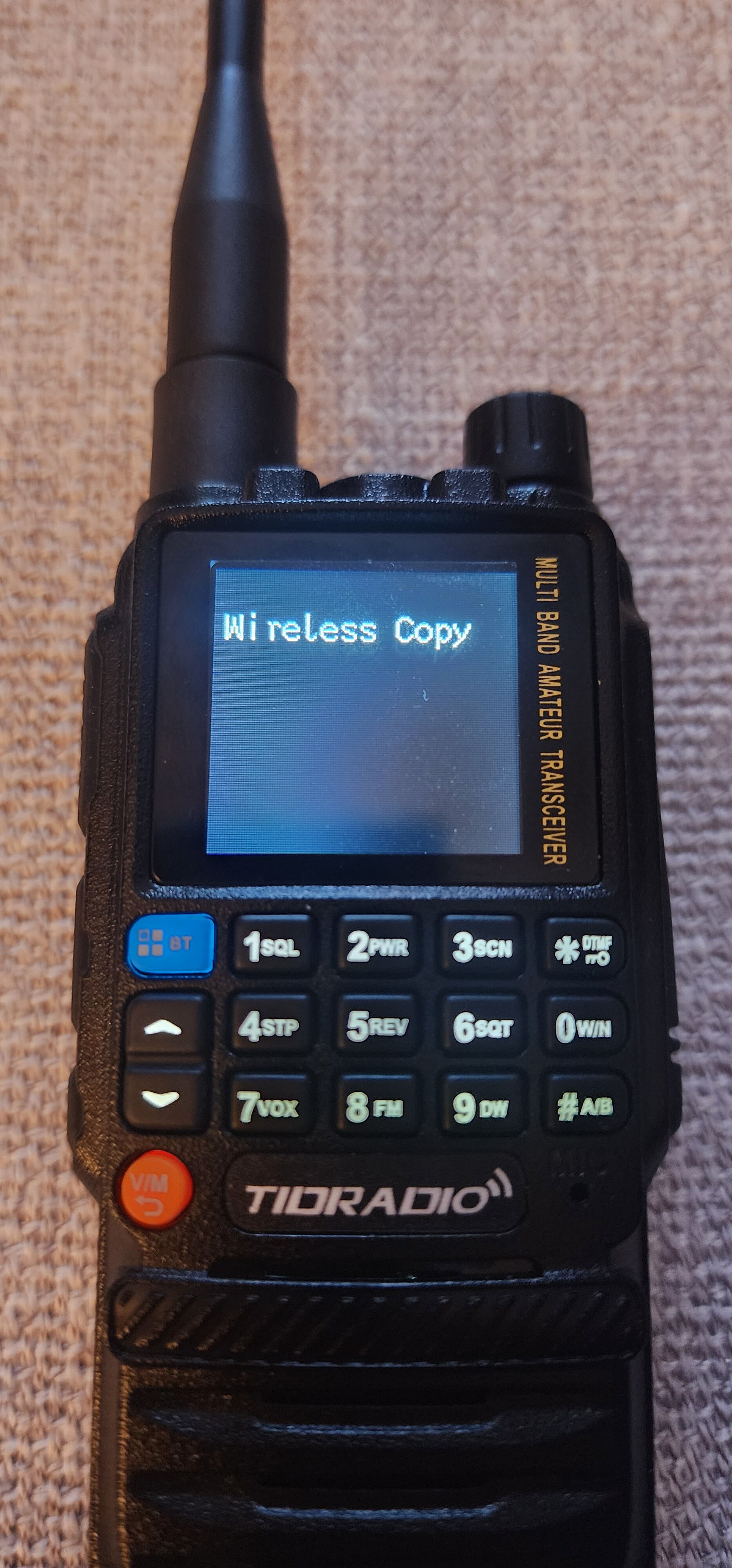

Like the TD-H8, the H3 also has the ability to clone itself via bluetooth. You do this by holding down the bottom side button while turning the radio on, resulting in the following menu:
full
Since I only have the one unit, I did not test this feature, but there are youtubers that show it functioning as advertised.

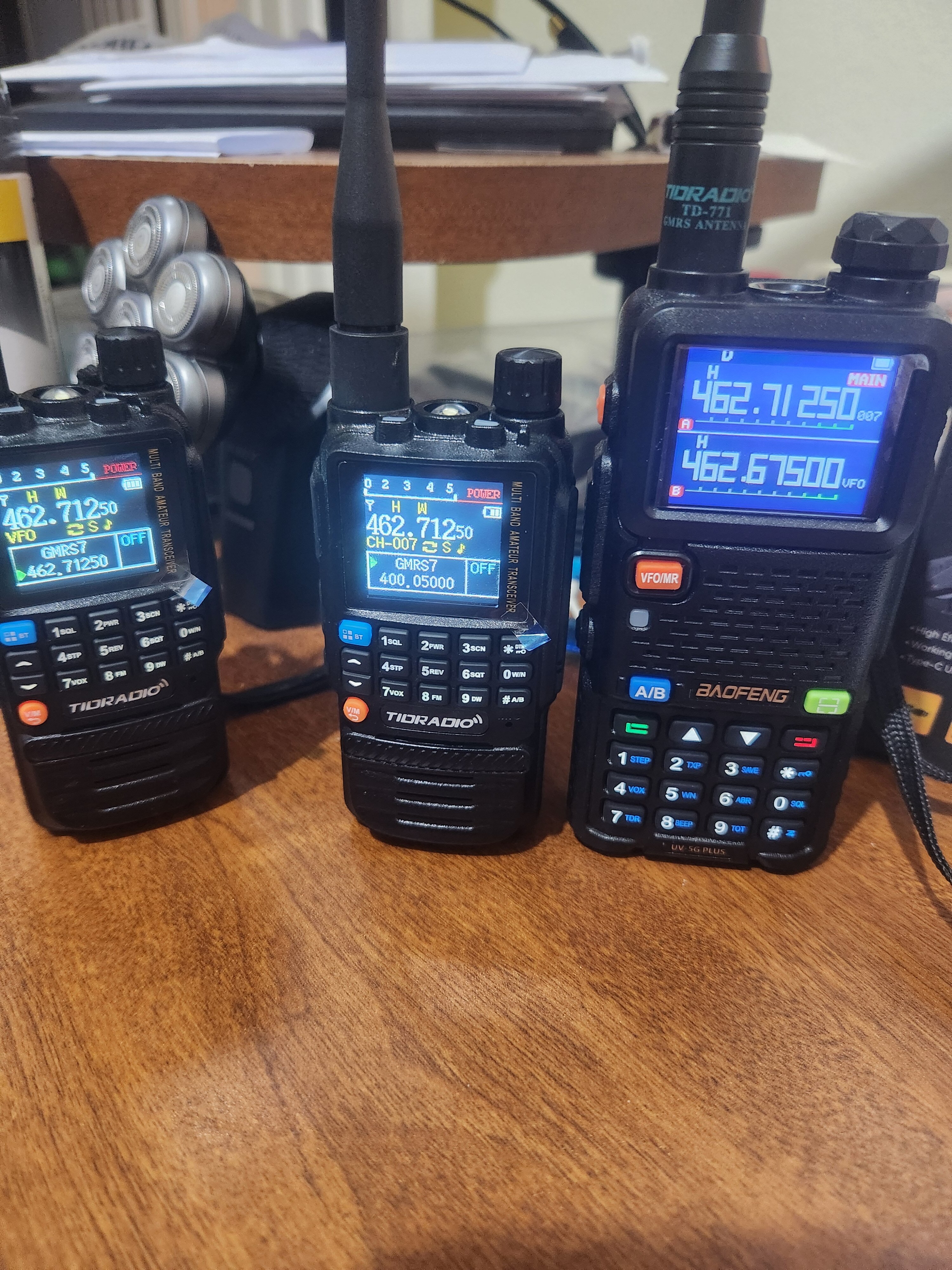

I've just gotten two of them today. We will see how they get on, so far they are more user intuitive than my UV-5G Plus GMRS and easier to use abiet mechanically more difficult with my giant sausage fingers.
