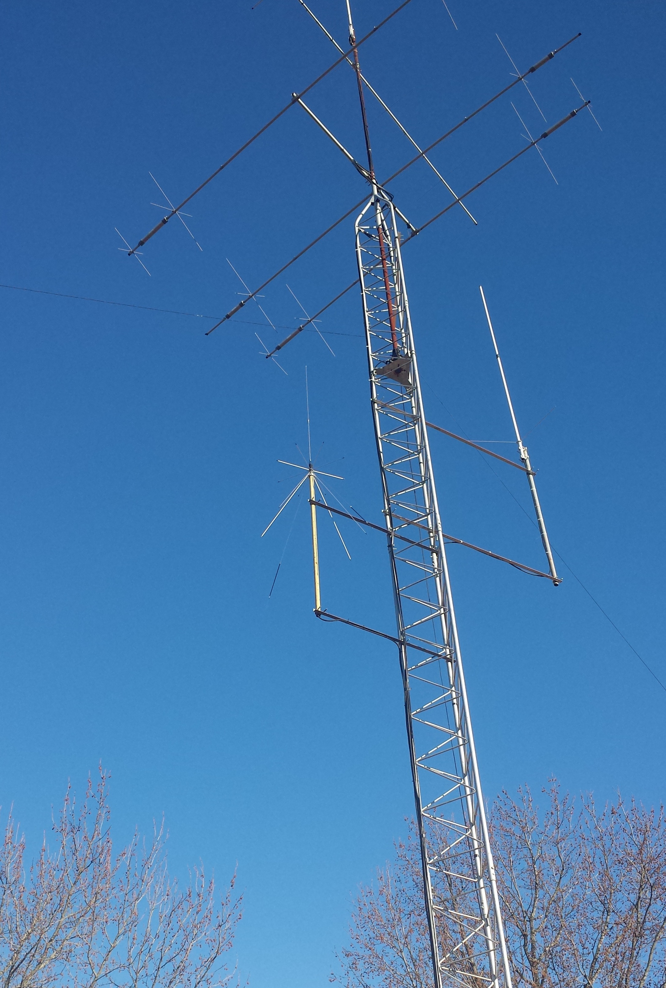

A couple of my homebrews.. Angle iron, spare mast, U bolts..
Thanks. I was thinking of doing something similar....homebrew. How far do they stick out from the tower????
The discone is on 4 ft angle iron and the tri band vertical if I remember correctly is on 6ft. You can also use aluminum angle if your load is an issue.. its also lighter to hall up and mount. I used 6ft on the vertical to get out as far as possible to avoid interaction with the tower. It seems to work fine with minimal nulls.
