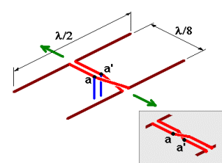

PS: The "Lazy H" laying horizontal (W8JK) works very well. I have one up I use on 80/40/20 fed with a manual tuner and 300-ohm twin-lead @40+ feet (12m +/-).
73 Gary
