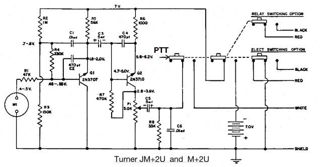

turner m+2u wired to 4 pin on omegaforce-s45

anybody know this?also does the mic wiring have to be changed inside because of relay and electronic switching!!
The 4 pin mic plug on the S-45 has exactly the same wiring as a Cobra, Ranger, Gawell as the S-45.laxy, and Uniden. If you wire the mic as to a Cobra, then it will work on all of those radios - as well as the S-45.
