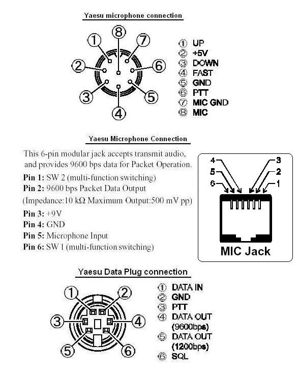

Just got a Yaesu FT-757 on EBay. It comes with a hand mic but I'd like to use it with a desk mic. I have a nice Tuner Plus Three that I'd like to use. I know the stock Yaesu mic has "up/down" buttons but I don't generally use that sort of feature except when operating 2-meter mobile and switching memory channels for different repeaters. Looking at the Yaesu mic wiring diagram in the manual it looks like I only need 3 pins on an 8-pin connector, but I'm not sure how to integrate the Turner wiring into that. Can someone help me out here, please?

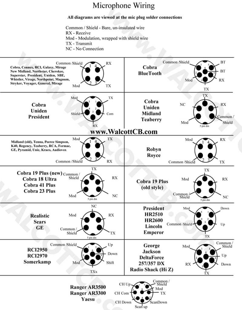

Good evening. Not sure if this might be of any help. I had the turner wiring somewhere, but for the life of me cant find the pic.
*found a substitute pinout for turner +3*
