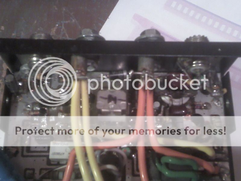

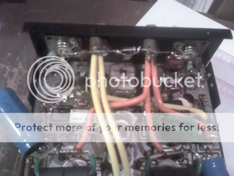

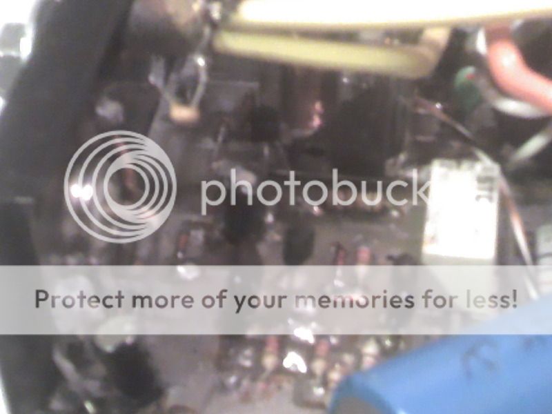

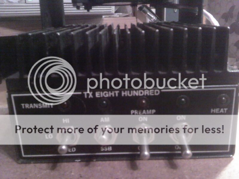

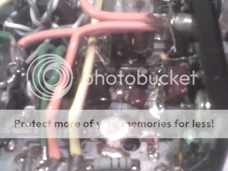

I have this amp here, and I need to find out the pre amp section on it and what transistors are the correct ones for it, it transmits super, but no pre amp, here is some pictures ot it.
In the fourth picture, There are (2) 3 legged transistors. one is for the key up, the other is the rx amp. Your pictures are pretty blurry, so I can tell which one is the rx amp. The easiest way to tell is to desolder and lift one leg of either transtistor. If the amp stops keying, then the other is your rx amp. usually the transistor closest to the relay is the keying transistor.
TX EIGHT HUNDRED
OK so it would be the one farther back. both are 3904's but I tried changing to 2907's but no rec butthere was tx, then I switched them back and when I turn n rec the little relay clicks but no rec. there is 2 47 uf 25v caps there inthat area? 4 4148's also I replaces all 5 4148's. there is also a 3906 on the other side of that bigger relay, you can see it a little in the 3rd pic down that bigger one is for the TX, that works fine,
