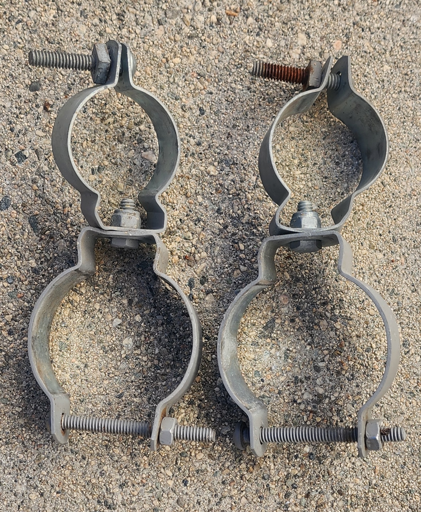

Years ago, I was looking for a vent pipe mount for a small 2 meter yagi that I wanted to mount on a small TV rotator. Not finding anything in the stores, I stumbled on conduit hangers, which allow you to bolt together different diameter conduit together. I used two sets of these hangers, plus a large U bold around both masts in the middle for insurance. Fast forward from the 2 meter yagi, I took it down and put up an M2 6M 3 element yagi on the same mount. I used this arrangement for years with a 6' mast with no problem, even surviving Santa Ana winds in SoCal up to 60 mph.
full
At some point, I put a W6LVP active receive loop on top of the yagi. The small coax loop weighs nothing, so this worked very well. Fast forward to last week when SoCal experienced the worst Santa Ana wind event I can ever remember. We had gusts measured at 93 MPH in my neighborhood! The conduit hangers didn't survive, twisted in the wind and the yagi came down.
So a warning for others who may try this type of mounting arrangement: Keep the antennas small and it will work fine in moderate winds. Don't try this for anything larger than about a 2m 4 element antenna and don't do it if you live in an area subject to severe winds; it won't survive.
