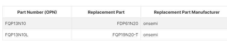

Is the FQP13N10 now obsolete? I try to avoid using obsolete parts, it's hard to duplicate performance and reliability in the event the devices need replacing in the future.
