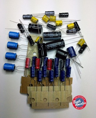

If your re-capping that radio this is probably your best bet. This seller is also a trusted forum member here.
