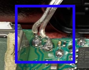

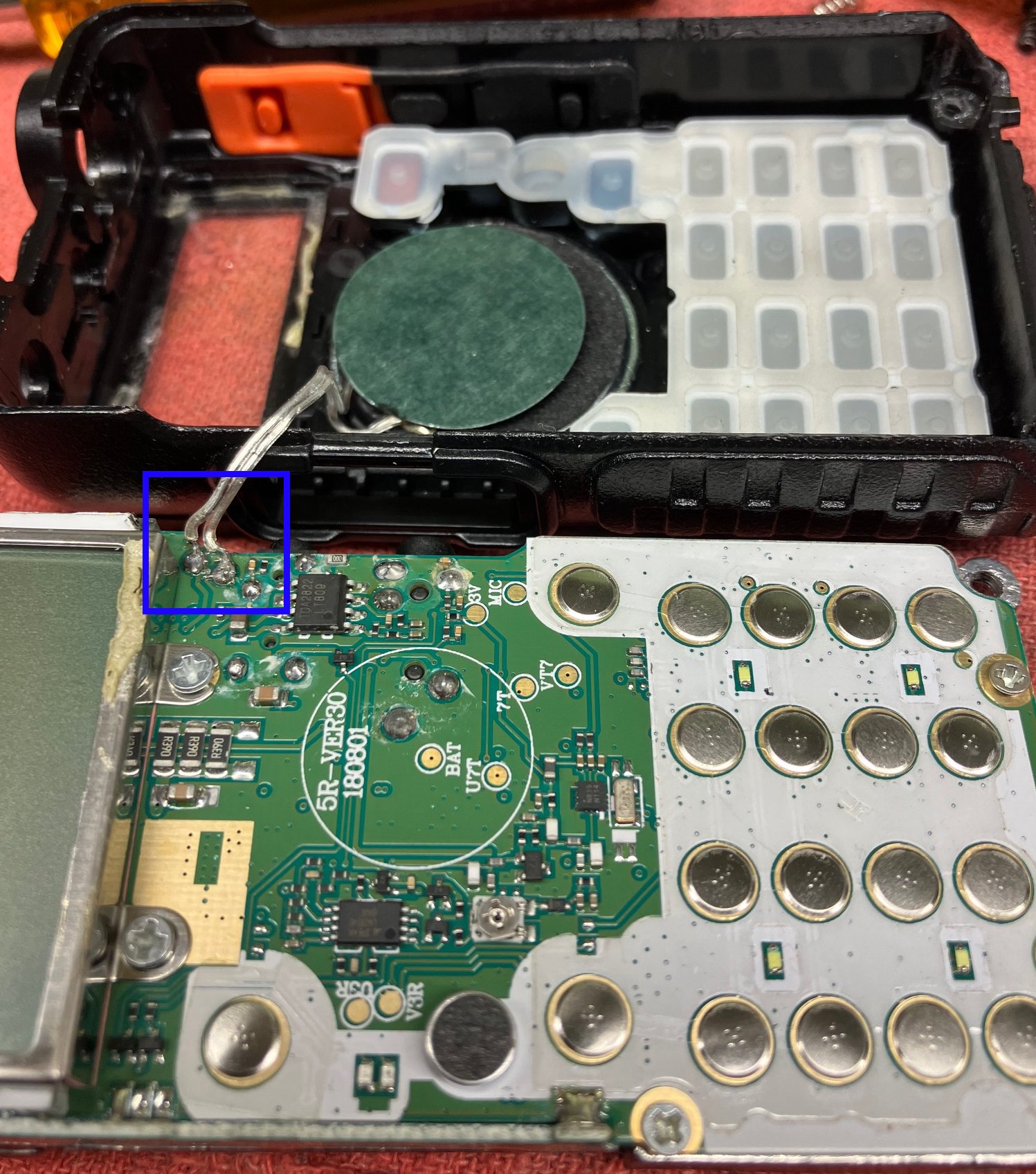

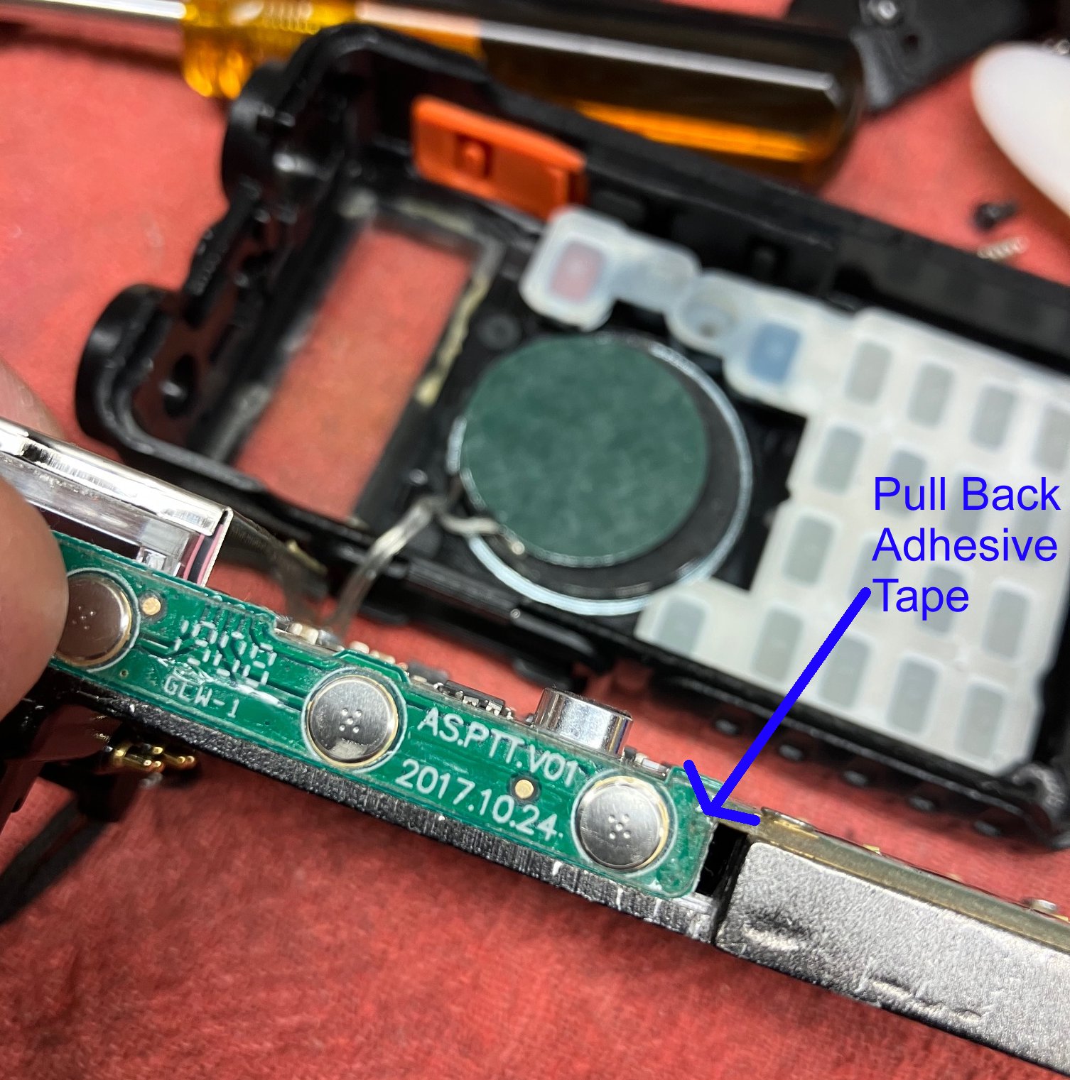

Here's the pictures including one of me getting my first rf burn after decades in electronics. The blue square shows where the speaker wire wasn't soldered very well at the factory. The "clickey"s on the board are held down with adhesive sheets that can be peeled back with some careful effort. I cleaned a couple with alcohol and scuffed them up a bit too.
