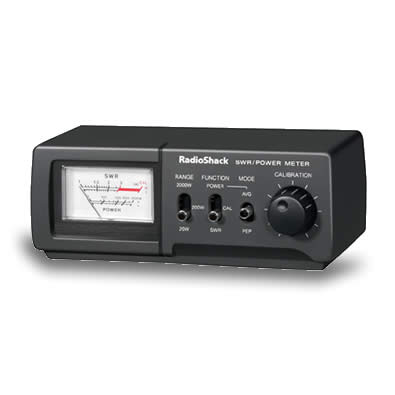

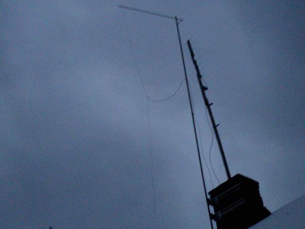

i think a few things may have been overlooked here.first you will need an swr meter to check your match.second you can always use a car battery to get you started.third them 102 in whips from rat shack can be used as a base antenna.i made a dipole antenna with two 8 foot pieces of wire and soldered them to the coax i will try to throw some pics up for you to get an idea.

The E-how description of building an antenna for CB leaves a lot to be desired. The author's description seems to indicate that the Half Wave Dipole is joined at the ends to form a sort of end-fed-half-wave-mutant-folded-dipole. What you have drawn probably wouldn't work very well. Now, if you don't join the ends together, and stretch it out horizontally, or vertically, as 1342 has done, you will have a very fine performing antenna.
