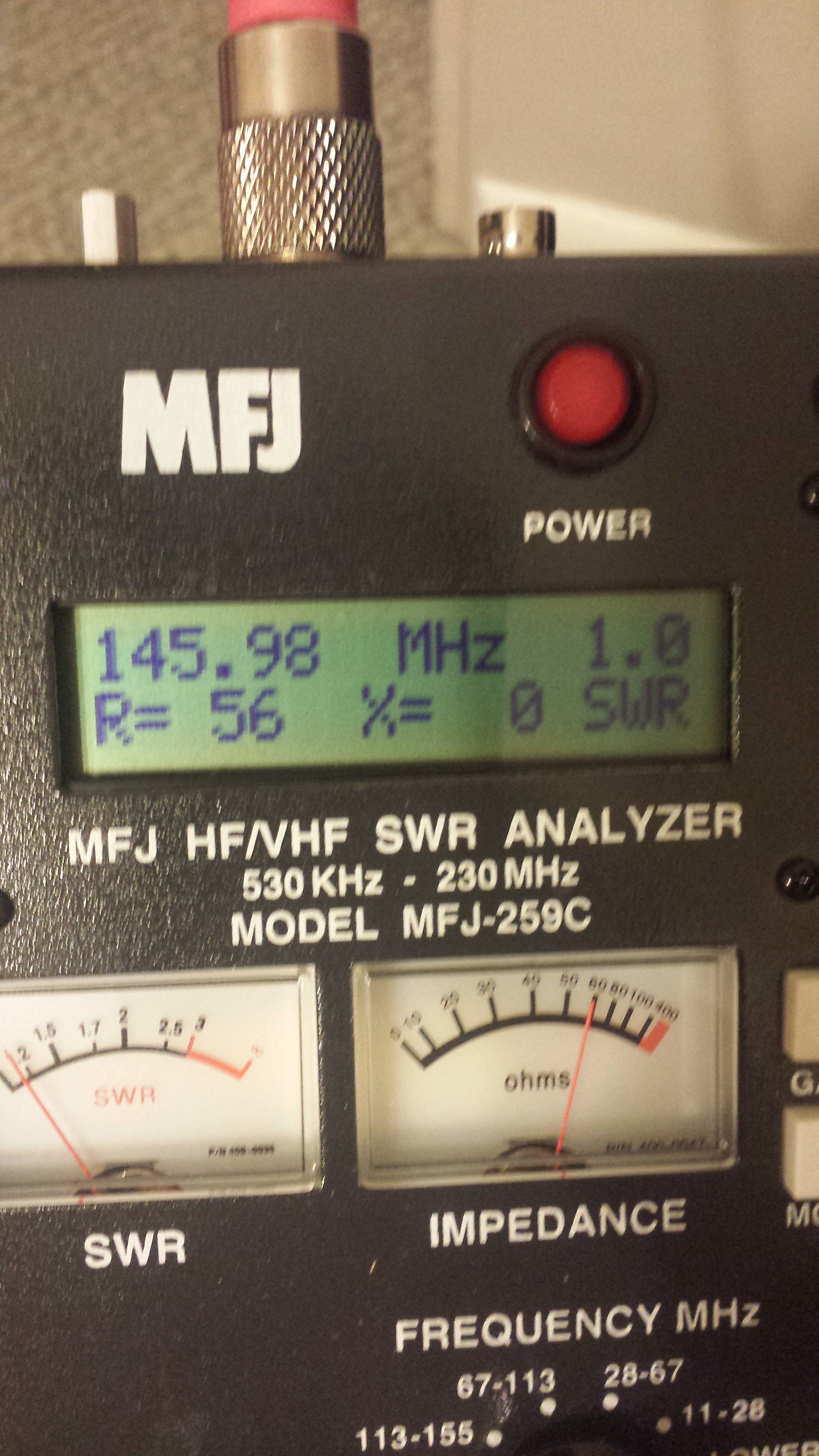

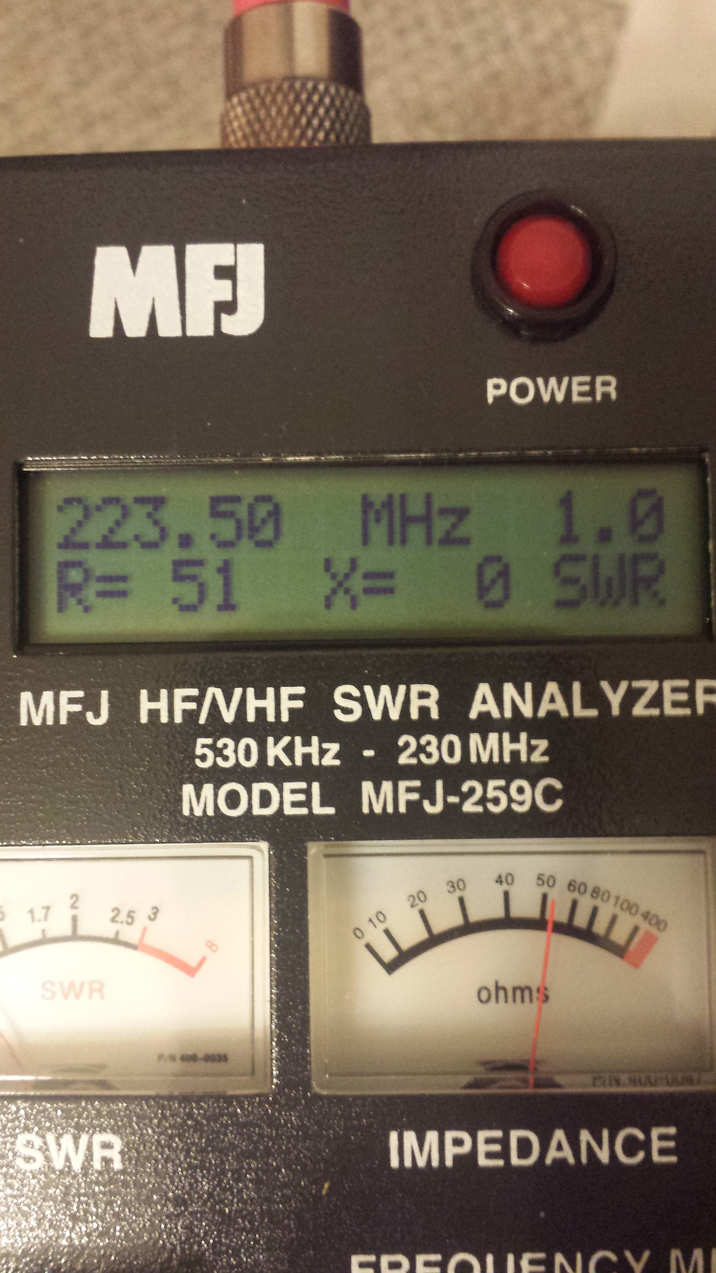

The CX-333 is not a good choice (I have one). The 2-meter SWR curve is best at 142.5 MHz. It is relatively narrow, considering that transmitting for 2-meter FM is between 144.5 to 147.99 MHz. According to my Comet antenna analyzer it could not adequately cover the repeater sub-bands on 2 meters. I found this out because I noticed that my TS-2000 was only putting out 25 watts on one of the repeater channels, and the other hams had trouble hearing me through that repeater. The SWR at the input frequency of the repeater was 3.8:1. I'm going to try to tune the antenna, but that will probably de-tune the other bands.
It's unfortunate to hear your results. I also run a cx 333 mounted on a stand off at roughly 36ft. I have been satisfied with my results. 1.5 at 144mhz and 1.7 at 148mhz. 146mhz right at 1.0. On 220 I usually chat with some locals 20-30 mi out on 223.500 simplex. It's 1.0 on this freq. My mfj 259c doesn't cover uhf so I can't give exact figures. According to my swr meter it's acceptable throughout the band portion i use. Weekly I chat with some elmers on 446.000 simplex w 10 watts. They are 20-30miles out. I can only compare the 333 to a diamond x50 and x200. On 2m/70cm it seems to work as well if not better than them. I also have a buddy that runs a 333 at 20 ft and he's pleased with his results. You might have a defective 333 or possibly a problem somewhere else. Hopefully you can figure it out. 73... 20170314_072416.jpg20170314_072751.jpg
